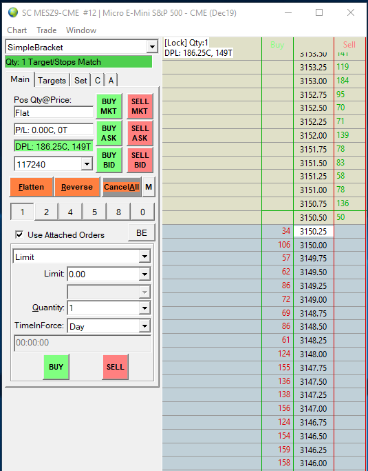

My Daily Profit/loss Field is showing an inaccurate amount. 186.25 when it should be 50.
The first trade I took today stopped out for a small loss but the DPL said I had gained money.
The current DPL shows a profit more than 3 x larger than what I have made today.
In some instance it shows that I have an open position in the stats window.
I have verified this on Rithmic trader. Position is closed and verified as 50.00.
The DPL amount was also incorrect yesterday.
This is for the MESZ9-CME contract.
Please advise
imageDPL.PNG / V - Attached On 2019-12-06 17:56:08 UTC - Size: 43.52 KB - 667 views

I'm having exactly the same issue. I had one trade, Rithmic shows it was 1 point profit but the trading window shows -24.50 pts loss. I recently started a tryout and initially everything was fine but at some point DPL broke and today is the 3rd day that it shows some weird numbers. Clearly something is wrong how DPL is calculated. And btw, my DPL was 0 at the beginning of the day and I had no open positions. Also tried to play with "Include Open P/L in Chart/Trade DOM P/L Display (NPL)" - nothing happened, as expected as I didn't have any open positions.
Now I could be wrong and I don't want to confuse the support by pointing to the wrong direction but I believe it happened on the night when I had an open position with bracket orders at the end of the day, I closed SC for the night and my position was stopped out overnight. If I remember correctly starting from that point DPL was completely wrong and it never corrected. I trade MES on that instance.

Regarding post #3 and #4 go through the simplified steps here:
Help With Daily Profit/Loss Value: Simplified Steps to Solve Incorrect Daily Profit/Loss
As long as you do not have any missing order fills, you will not have a problem.
And this is why we recommend users use the Sierra Chart Order Routing Service which maintains complete and long-term order fill history. One of you is using CQG and the other Rithmic.
[2021-02-04 13:48:49]
FT63 - Posts: 17
I deleted trading activity from the date when the order was executed on Rithmic server when SC was not running and that resolved the issue. After I reconnected to the data feed trading activity didn't restore from Rithmic, which is not a bid deal for me as long as I can track my DPL properly. Next time I will try to identify and delete the activity that causes the issue instead of deleting all in bulk.
