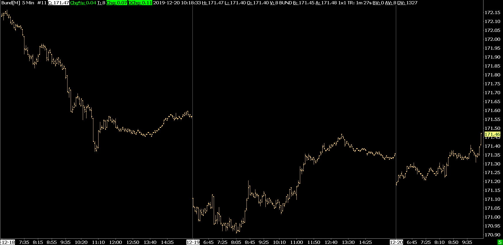

Bunds offered by FXCM also doesn't work properly on Sierra.
For example, there is no data pre 11am London time (6am NY). Basically the Bund chart is messed up.
Thanks.
[2019-12-20 11:10:49]
User907968 - Posts: 884
Maybe check your chart session times, as I can see FXCM BUND data from 0700-2100GMT no problem.
Chart Session Times: Session Times

[2019-12-20 15:17:32]
We did contact FXCM again about WHEATF. They are just not providing market data for it on our FIX connections we use for market data. So this is an issue on their side. We will wait to hear from them.
If they are making this complicated or difficult, this is not our fault.
Understand we now also have a delayed data feed available where you can receive the actual wheat futures data streaming with full detail and depth:
Delayed Exchange Data Feed
Regarding BUND CFD . This is the chart we see:
http://www.sierrachart.com/image.php?Image=157685513741.png (Time zone is US Eastern)
As was said previously check the chart Session Times in Chart >> Chart Settings.
Date Time Of Last Edit: 2019-12-20 15:20:04
[2019-12-20 15:33:54]
Calculus - Posts: 150
Thanks Sierra, we know you're working for us even if some other companies aren't playing ball.
907/Sierra, worked a charm re chart session times. My DAX was also getting messed up, so that was fixed as well.
