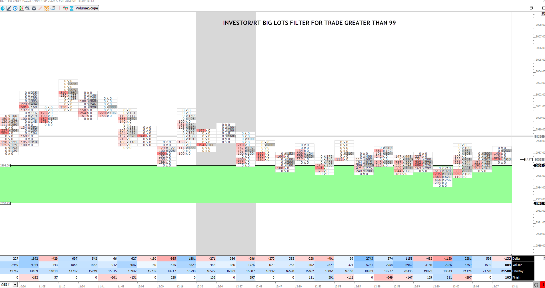

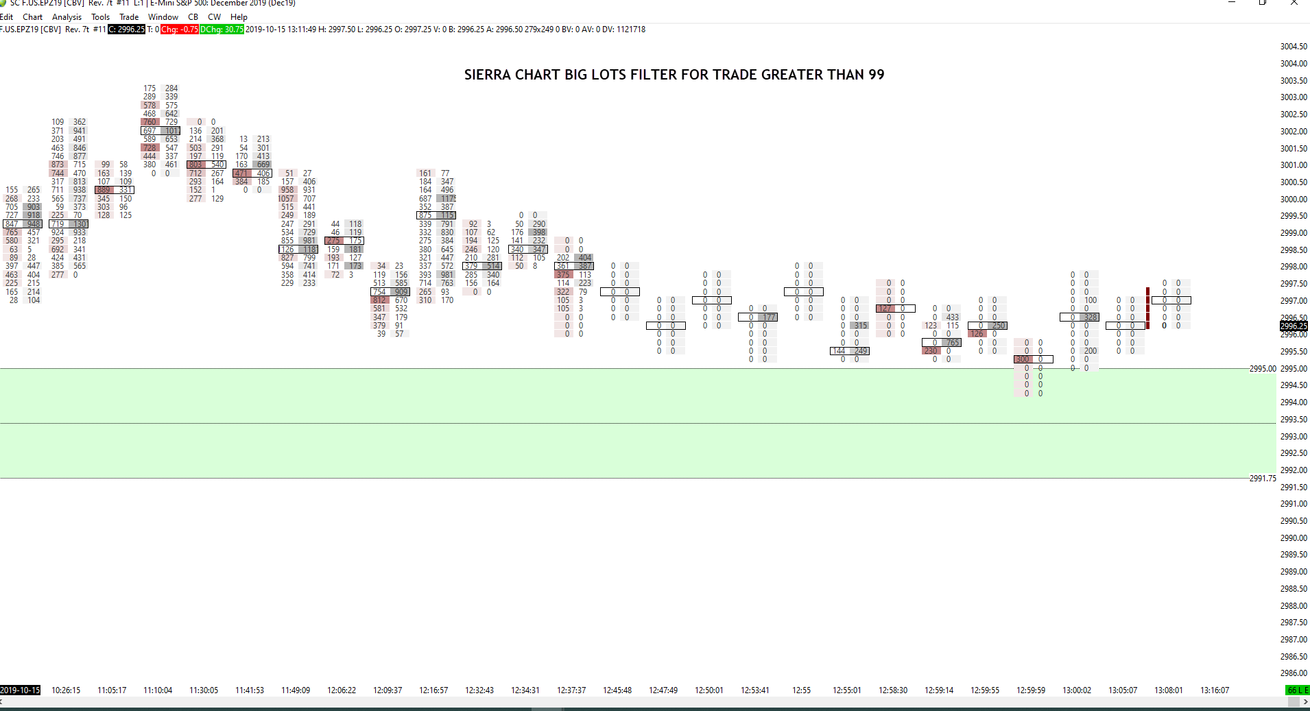

I am having difficulties in trying to get accurate volume filters for trade sizes that is set to a particular number say (trade greater than 99). However, I believe I am not getting accurate filter for this sizes.I am not sure if there is a settings in sierra chart that I need to change. I did a comparison with other platform (Investor R/T) and filter for the same size, I received lots more filter big lots sizes compared to sierra chart. Please assist me with fixing the problem I have attached an image of both filters for sierra and other platform using 7t reversal bar.

Make sure you are using the Volume Filter settings correctly:
Chart Settings: Volume Filter (Chart >> Chart Settings >> Data Limiting >> Volume Filter Settings menu)
And you also need to switch to this data feed:
Denali Exchange Data Feed
After using this data feed re-download the data in the chart:
Re-download all the data in the chart by going to the chart and selecting "Edit >> Delete All Data and Download". You just need to do this once per symbol and not for each chart.
And then use this option:
Chart Settings: Combine Trades into Original Summary Trade (Data Feed and Exchange Specific) (Chart >> Chart Settings >> Chart Data >> Chart Data menu)
