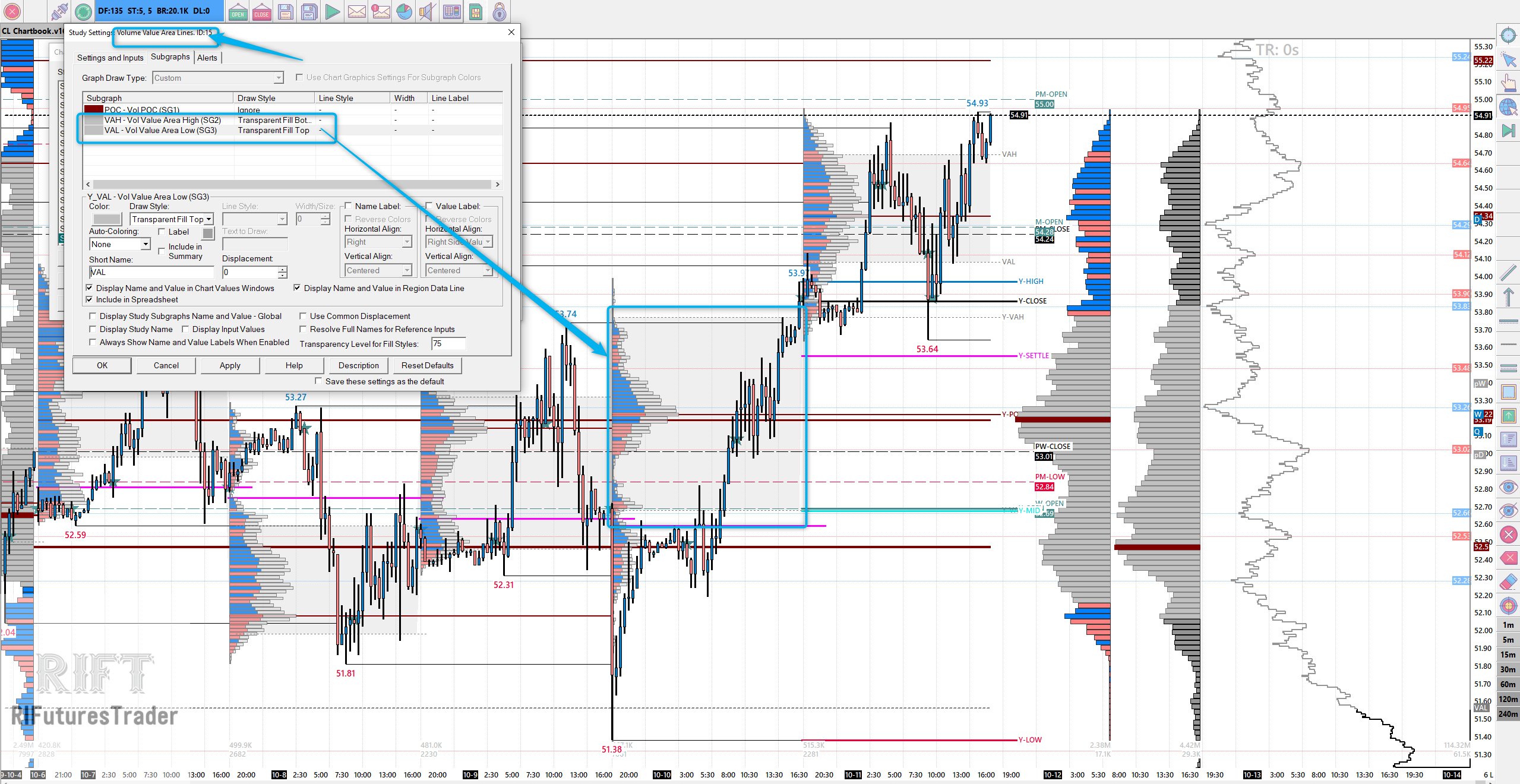

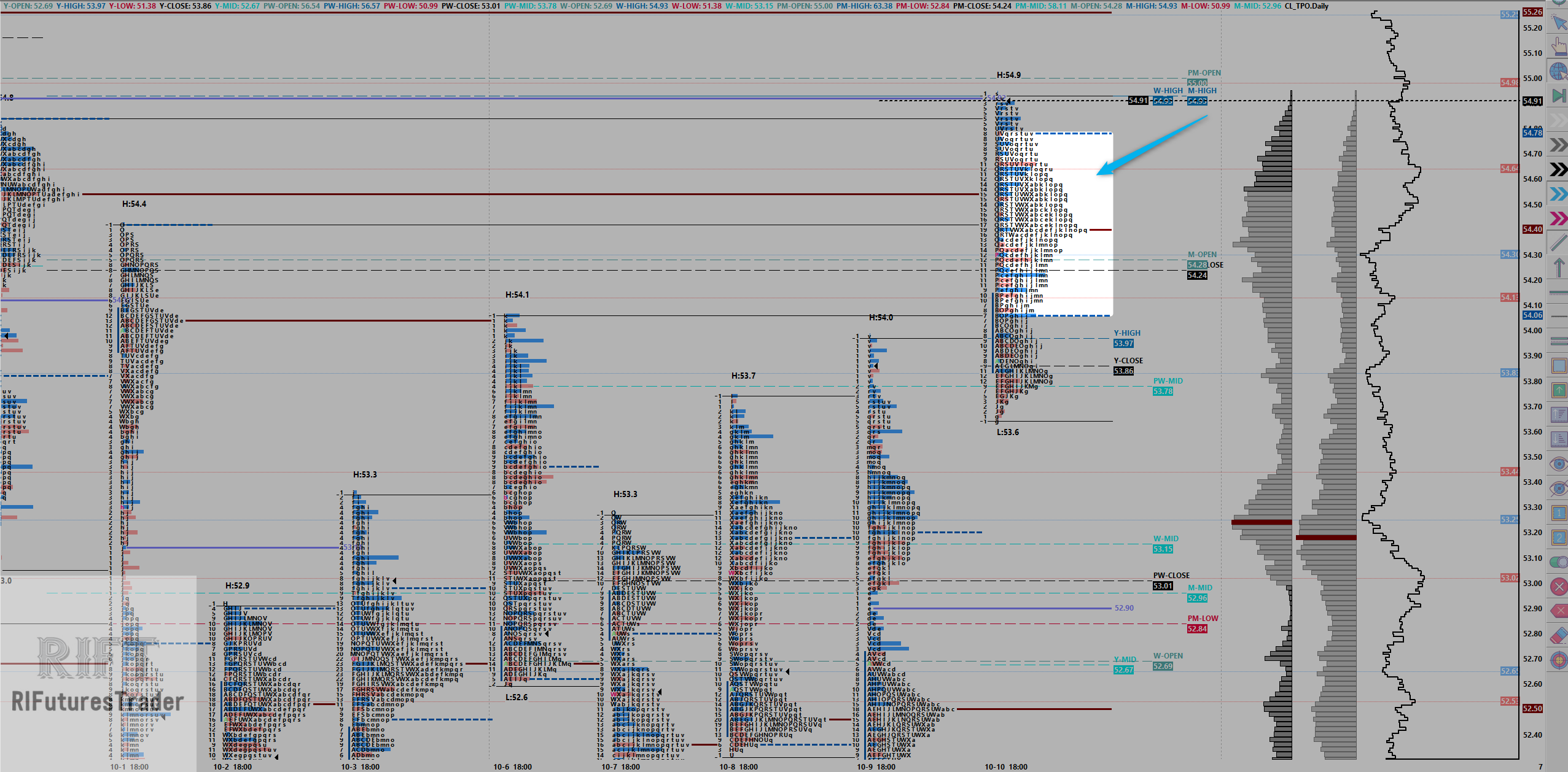

I would like to make the value area transparent background on the Market Profile chart, as well as on the chart with the volume profile.
I tried to do the "TPO Value Are Lines" study, it does not work, is there a way to do that?
Thanks!
image2019-10-12_13h16_55.png / V - Attached On 2019-10-12 11:26:35 UTC - Size: 323.51 KB - 689 views
image2019-10-12_13h03_40.png / V - Attached On 2019-10-12 11:26:48 UTC - Size: 367.02 KB - 580 views

What is the purpose of making it transparent for a TPO Profile chart? It is also supported to color the letters themselves which are within the value area rather than the background.
In the case of the Volume Value Area Lines you can use the transparent Fill Draw Styles. Refer to:
Chart Studies: Filling the Area Between Two Study Subgraphs within Same Study
