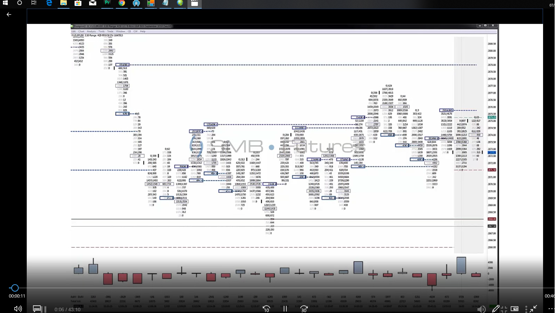

How can i setup a chart like the attached file?
imagefootprint chart.png / V - Attached On 2019-10-07 17:27:09 UTC - Size: 839.88 KB - 731 views

GreegT - Posts: 23
Set column 1 to bid vs ask, turn the other columns off. Set it to highlight minimum and maximum. From there its just a matter of adjusting colors; such as, text range from grey to black, background off, etc

You will need to use the Numbers Bars study:
Numbers Bars
If you have no background with working with the Numbers Bars study, then you can download the following Chartbook which is setup to have a Numbers Bars study to give you an idea of how to get started:
https://www.sierrachart.com/AdditionalFiles/NumbersBarsExampleChartbook.cht
Refer to the information here for how to use this Chartbook:
Chartbooks (Workspaces): Using a Chartbook Provided by Sierra Chart Support
