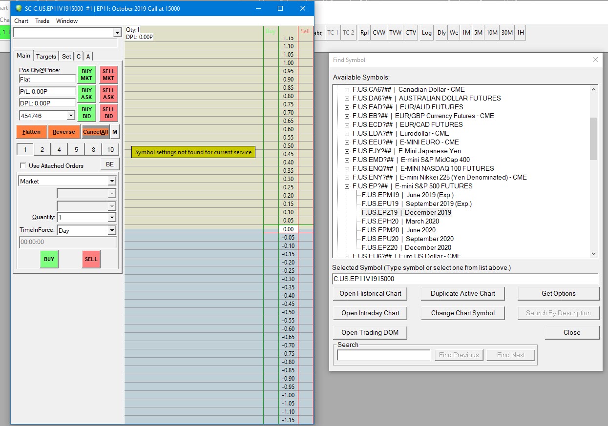

My question is about trading options with CQG data on Sierra Chart. I can gain access to the list of options for a specific symbol, but when I attempt to open a DOM or Chart for that option, I am presented with the message: “Symbol settings not found for current service”.
Is this something that needs to be enabled on Sierra Chart’s end to access these options? Or could I be doing something wrong? I’ve followed your support guide on your website for this topic, but can’t seem to shake this error message. According to AMP, our live CQG account should be able to trade with these options.

It is completely safe to ignore that error message about symbol settings not being found. It will occur for option symbols when using CQG because there are no pattern matching symbols set up for them.
But that is not needed. What is one of the options symbols you are looking at and we will see if we can set up a pattern for it .
Also this service supports options as well:
Sierra Chart / Trading Technologies Futures Order Routing Service
And it supports getting automatic listings of option symbols as well for particular futures contracts.
I was attempting to open a DOM/Chart for the C.US.EP11V1915000, both of which present me with the "Symbol settings not found for current service".
Is this a limitation of options trading on CQG? Or does it fall back on the pattern matching symbols?
Attached is a screenshot of what I am encountering.
Thanks!
imageSierra Options issue.jpg / V - Attached On 2019-10-01 20:08:56 UTC - Size: 223.61 KB - 511 views
[2019-10-02 21:00:28]
Yes.
