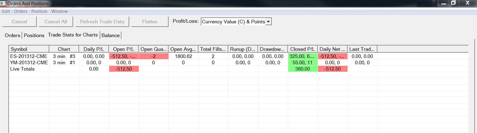

[2013-12-08 10:19:05]
salsem - Posts: 43
Hello Support SC ,
my broker AMP said that are flat,
SC 1060 (- 2 order open )
Date Time Of Last Edit: 2013-12-08 10:20:38
imageSC TTNet orders and positions.jpg / V - Attached On 2013-12-08 10:18:41 UTC - Size: 84.47 KB - 751 views
[2013-12-08 11:04:46]
This is a different kind of issue. This is the Trade Stats for Charts tab. Refer to the documentation here to clear that data:
http://www.sierrachart.com/index.php?l=doc/doc_TradeStatusWindows.html#TradeStatsResettingData

Post #7:
Completely clear the Trade Activity data for the symbol that your position is flat for following the instructions here:
http://www.sierrachart.com/index.php?l=doc/doc_TradeActivityLog.php#ClearingtheLog
This is all you need to do. This is what the documentation indicates to do in this particular case. The Trade Stats for Charts tab should not be relied upon to show your accurate position. It can be wrong because it has a dependency upon order fills and those could sometimes be missed for different kinds of conditions.
