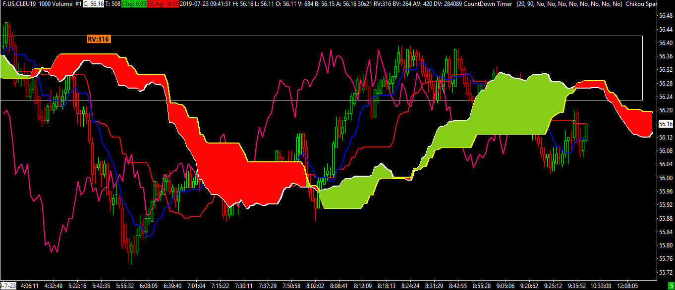

with the senkou span a&b I want the cloud to be see-thru green and see-thru red so I can clearly see the bars traveling thru it. how to do so, because I read a forum post on here about it but I cant seem to find what they are saying 'semi transparent' option
http://www.sierrachart.com/image.php?Image=1563892912739.png
imagecl.PNG / V - Attached On 2019-07-23 14:36:25 UTC - Size: 61.91 KB - 496 views
[2019-07-23 18:03:26]
John - SC Support - Posts: 48597
There are two things you want to do. The first is to set the study that is creating the cloud to draw behind the main price graph. To do this, go to the settings for that study and select the option for Draw Study Underneath Main Price Graph. Refer to the documentation for this here:
Chart Studies: Settings and Inputs Tab >> Draw Study Underneath Main Price Graph (in the same Chart Region)
The second one is to change the Draw Style for the subgraphs that are creating the cloud to Transparent Fill Top and Transparent Fill Bottom. That will fill the cloud in as a transparency based on the Transparency Level for Fill Styles setting. These items are on the Subgraphs tab of the settings for the study. Refer to the following documentation, and note the links to the other items in this section:
Chart Studies: Transparent Fill Top (ACSIL: DRAWSTYLE_TRANSPARENT_FILL_TOP) and Transparent Fill Bottom (ACSIL: DRAWSTYLE_TRANSPARENT_FILL_BOTTOM)

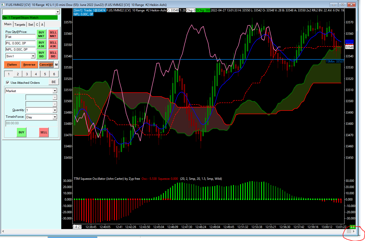

With Ichimoku, it plots the Cloud 26 bars into the future. In the chart I attached at the bottom I circled red to show chart current position with price. I want to have the chart fully display the Cloud 26 bars into the future and stay in sync with it as price moves it continues to show the cloud in the future.
imagered.PNG / V - Attached On 2022-04-27 18:02:18 UTC - Size: 106.28 KB - 354 views
[2022-04-27 20:38:54]
We think what you are looking for is the Lock Fill Space option. Refer to the following:

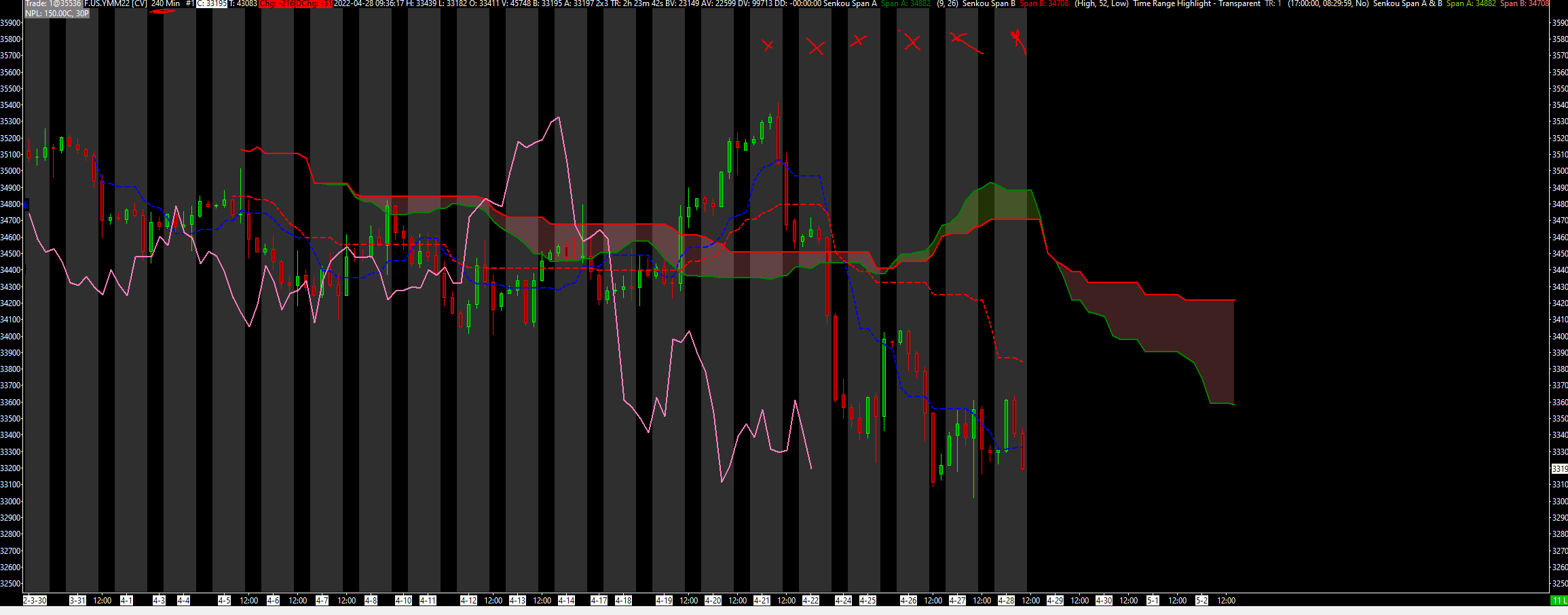

How do I remove the gray vertical blocks on the chart, to have it just display a black background

User628616:
That looks like you have a Color Background Based on Alert Condition study on that chart. You would need to find that study, or whatever study is creating it, and remove/adjust/edit as needed.

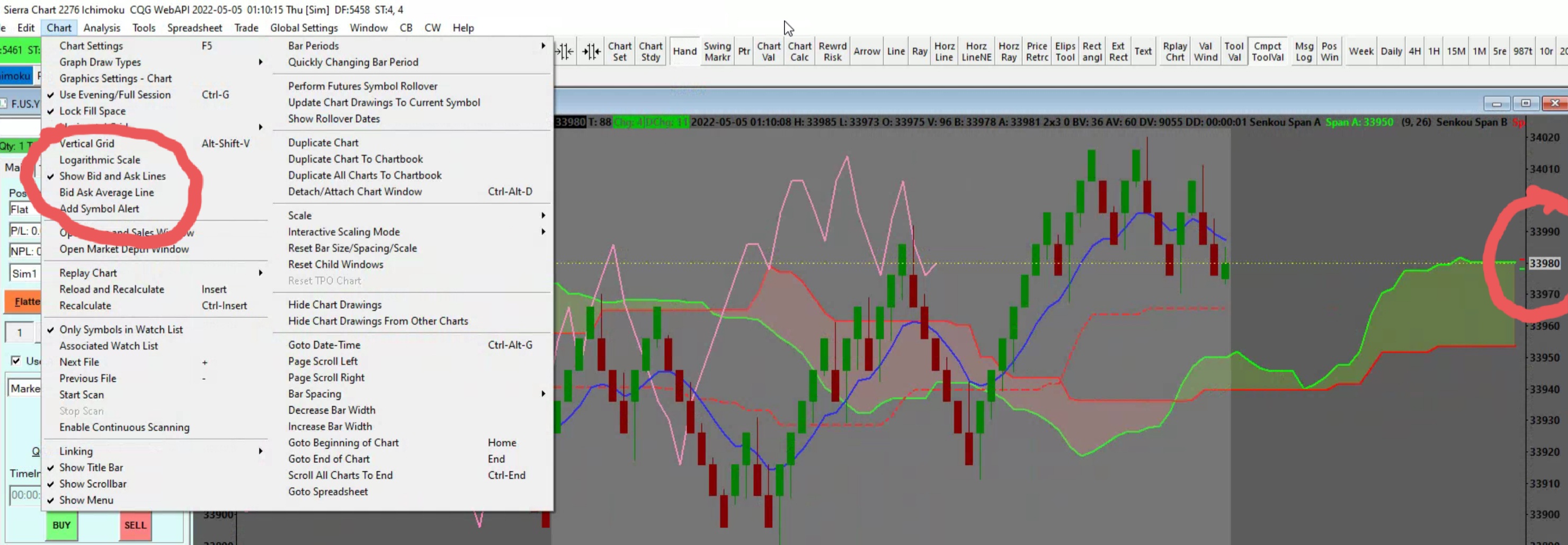

When I have the show bid/ask lines selected, it don't display correct with the lines extending out some with the prices and spread and percentage, how to fix
image20220505_011206.jpg / V - Attached On 2022-05-05 08:29:53 UTC - Size: 475.63 KB - 371 views
[2022-05-05 14:16:27]
That is all those particular lines extend. If you want to see them further into the chart, then use the Current Bid Ask Lines study. Refer to the information here:

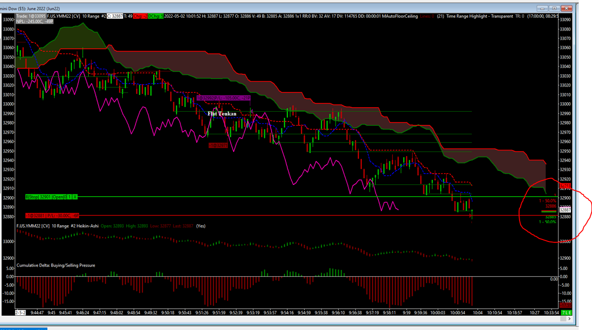

User628616 - Posts: 132
The circled area is how it used to be with the bid price & ask price, the percentage and right above it the spread. thats what i want. i tried the current bid ask lines study and that wasn't it
imageba.PNG / V - Attached On 2022-05-05 14:33:55 UTC - Size: 193.78 KB - 293 views
[2022-05-05 15:46:30]
What you are showing in that image is the DOM Graph. Refer to the following:
Trade Menu: Draw DOM Graph on Chart (Trade menu)
The only reason why it showing the Best Bid and Ask is because that is all you have available. If you were getting the full market depth data, then you would not be able to limit the DOM Graph to the Best Bid and Ask.

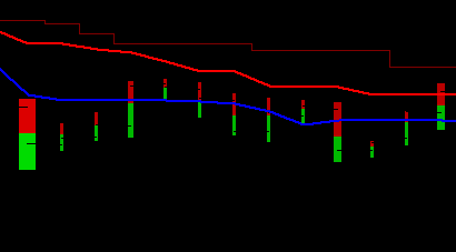

Is there any way when using the Bid Ask Volume Bars, to make the Open/Close line more visible (Thickness,Color)
imagebapb.PNG / V - Attached On 2022-05-05 21:41:18 UTC - Size: 3.55 KB - 284 views
[2022-05-05 22:23:32]
There is not a way to change those lines.
