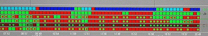

is it possible to divide a chart region into grids, and then populate each grid with a different study. Each grid would show the study rising and falling via a horizontal square. So one chart region could have 4 studies on top of each other showing different studies rising and falling using the 20, 40, 60, 80 horizontal grid
looking to see a momentum move in different studies at the same time.
ty
[2019-07-22 01:32:08]
User106601 - Posts: 17
https://www.sierrachart.com/Download.php?Folder=SupportBoard&download=30179
imagedom.gif / V - Attached On 2019-07-22 01:30:29 UTC - Size: 41.53 KB - 557 views

To do what you want in post #2 requires that you use the Color Bar Based on Alert Condition study:
However, we will need to add a new Input setting to have it support drawing at a custom value. So that you can use different values for each row.
Date Time Of Last Edit: 2019-07-22 18:15:48
Letting you know this is now in version 1957.
