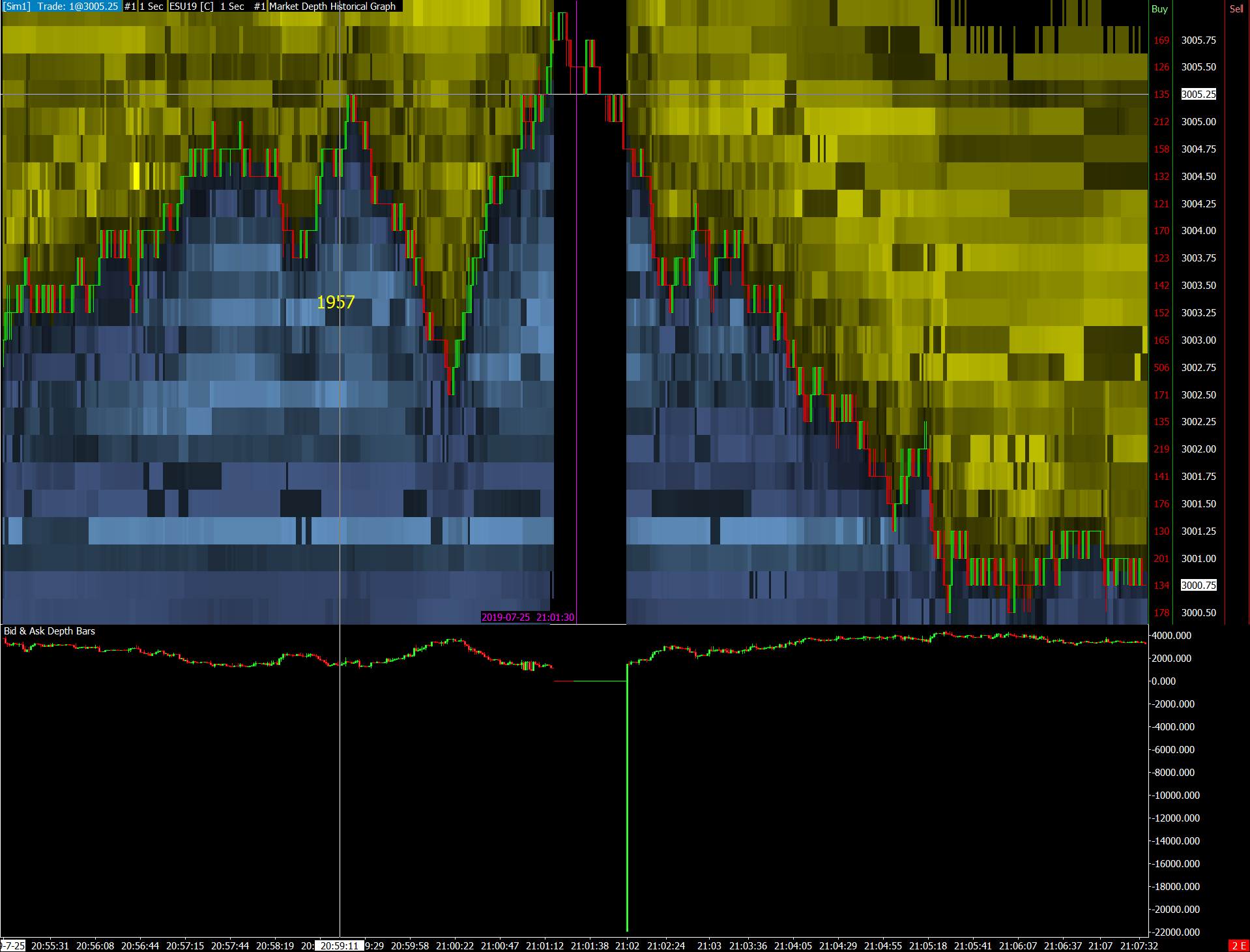

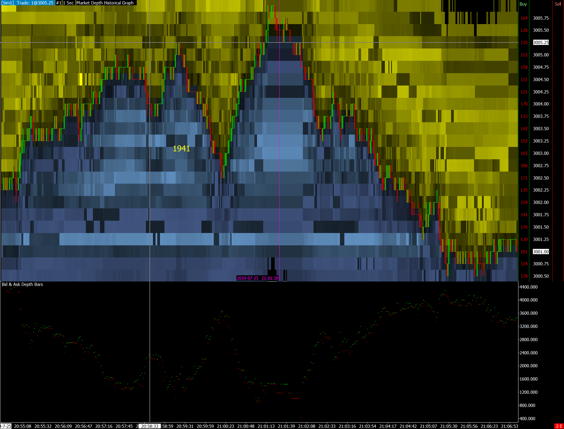

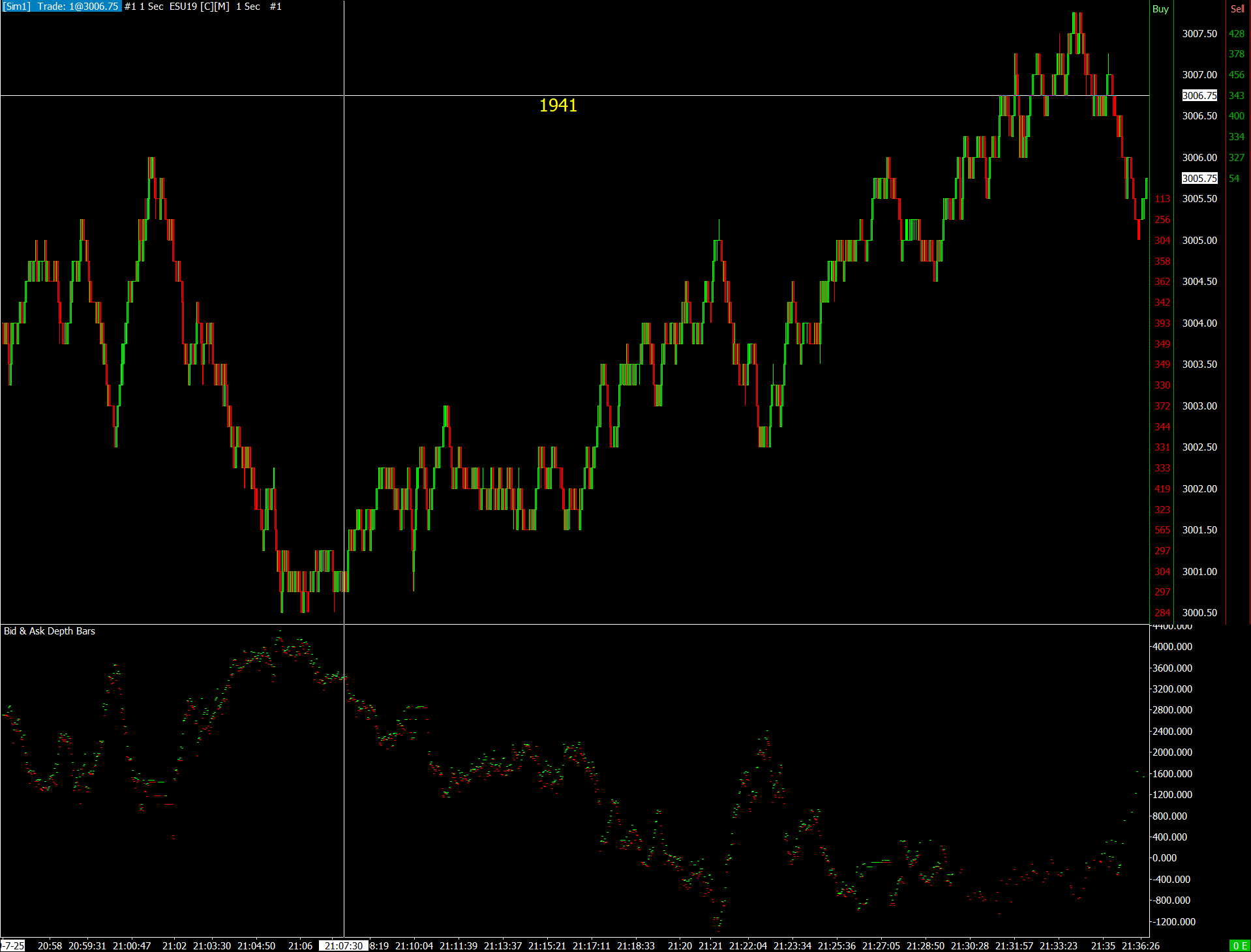

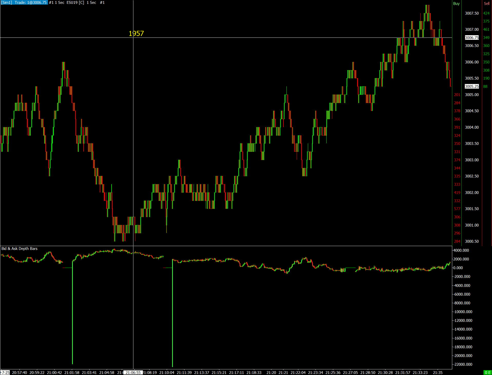

caligola - Posts: 116
1957
http://www.sierrachart.com/image.php?Image=1564083380349.png
1941
http://www.sierrachart.com/image.php?Image=1564083398963.png
same DEPTH file
the chart is the same, I did a copy of the SC 1941 chartbook so all chart settings are the same

We are trying to reproduce the condition that is causing the out of range values as shown in this chart image here:
So far we cannot reproduce this condition.
Provide us that chart by following these instructions here:
And is that chart from a sub instance of Sierra Chart?
Date Time Of Last Edit: 2019-07-26 06:03:21
[2019-07-26 09:12:05]
the chart is from a Destination instance as described here
https://www.sierrachart.com/index.php?page=doc/MultipleServices.html#AccessingMarketDataFromOtherInstancesOfSierraChart_Instructions
At the time of the screenshot this was the setup:
Source instance 1941
Destination instance 1957
Please find attached the chartbook
I have also experienced the issue having 1957 on Source and Destination instance but the downgrade didn't solved
I have noticed that if I add a Market Depth Historical Graph study, there is an hole in the DEPTH data but the file is the same (previously recorded in the Destination instance 1957)
1941, no hole
http://www.sierrachart.com/image.php?Image=1564131488804.png
1957, there is a hole
http://www.sierrachart.com/image.php?Image=1564131447703.png

[2019-07-26 19:14:16]
This is not a technically correct set up for the Bid and Ask Depth Bars study in the latest version. We would have to analyze why specifically you get the result that you do, but the study will not have the necessary data with this configuration. We will not spend further time analyzing this.
The study is only assured to show data and be correct, when using the latest version of Sierra Chart. Which is currently 1957. You must be using this version or higher consistently. Data from an older version will not work properly with this study.
This means there was no market depth data recorded there. There is a difference in what is displayed by default between the versions.
Date Time Of Last Edit: 2019-07-26 19:17:03
