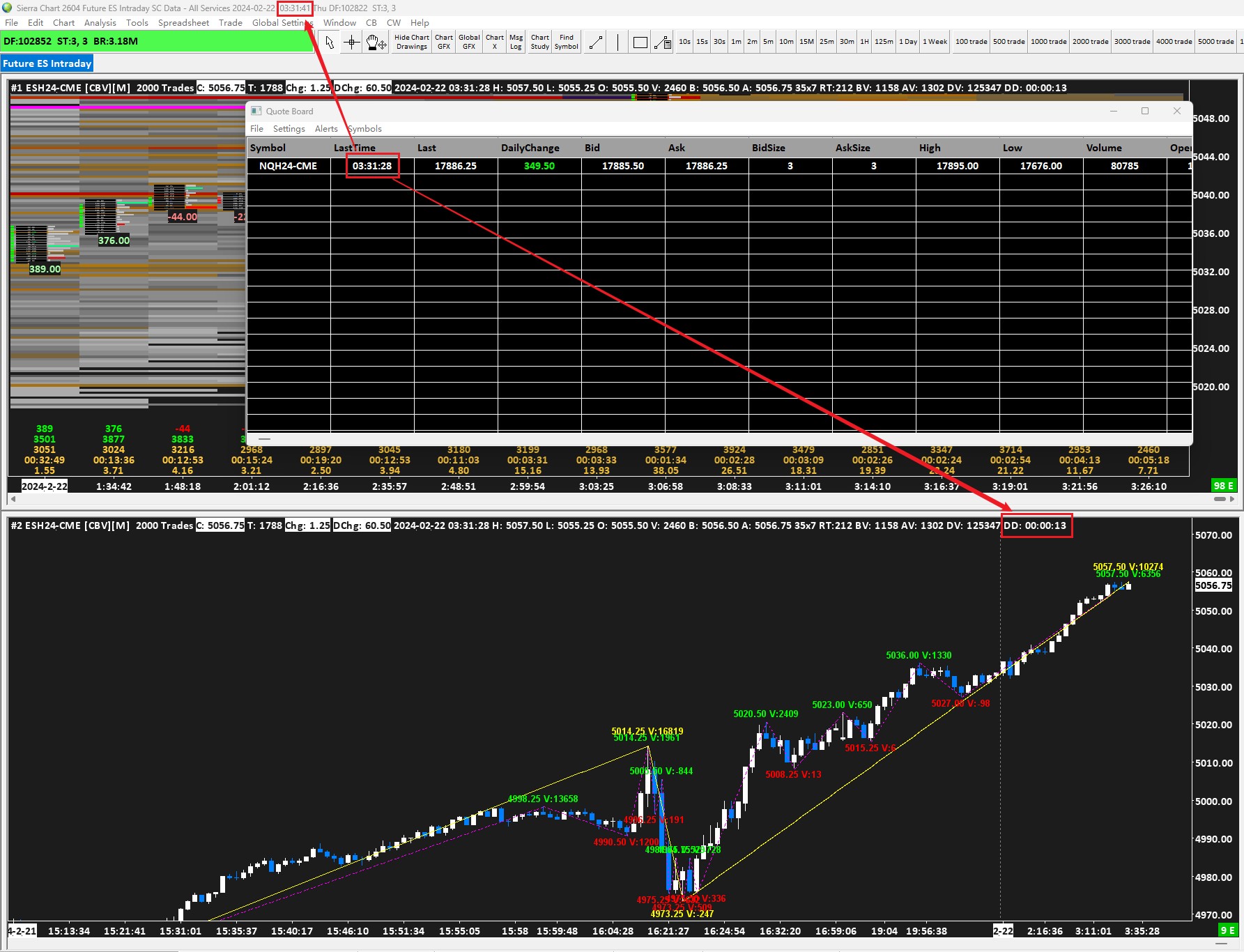

[2024-02-22 08:34:46]
JEROME7968 - Posts: 19
I am having the same issue, a constantly 13second of delay, everything working fine two weeks ago, I wasnt turning on pc for 2 weeks, and yesterday when I turn my SC on, I saw a constantly delayed 13 seconds of data and tried every method couldn't help at all, I have seen the quote board's last time update is having constantly of 13sec delay as well, but I didnt touch anything. I have tried install a new sierrachart software as well, but didnt help as well, no wonder I connect to Denali data feed or Rithmic data feed, the system is constantly delaying 13seconds.
Date Time Of Last Edit: 2024-02-22 09:08:56
imagedelay 13.jpg / V - Attached On 2024-02-22 08:32:54 UTC - Size: 449.46 KB - 158 views
[2024-02-22 09:50:43]
It goes normal again ..... my god, I didnt touch anything at all, hope that dont happen again
[2024-02-22 10:38:40]
Your computer clock was off. Enable the new NTP functionality in Global Settings >> NTP Settings.
