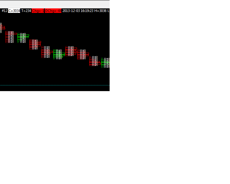

I tried with ENI and works with chart-hours minutes etc but not with graphic foot print as the attached chart "1 sierra."

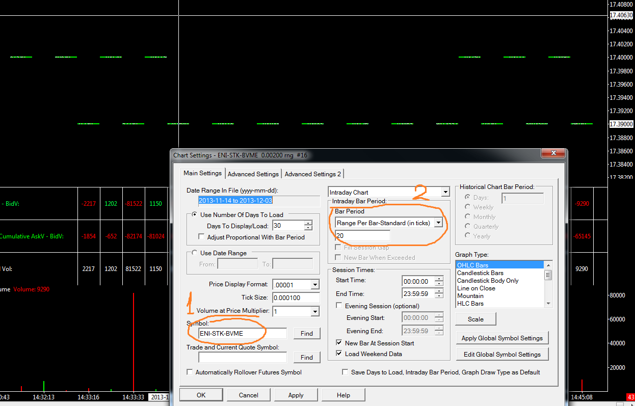

also attached chart "2 sierra" of ENi where I can not make the setting as in Figure 1

We do not see any attachments here. Interactive Brokers does not provide the proper data for the Numbers Bars study.

IF so 'would you tell me who kindly providing these data for U.S. equities and ITALIAN be able to view and study Bars Numbers? thanks

Probably you will need to use Interactive Brokers for Non-US stocks and stay connected as much is possible to TWS to build up the Bid volume and Ask volume data for Numbers Bars.
