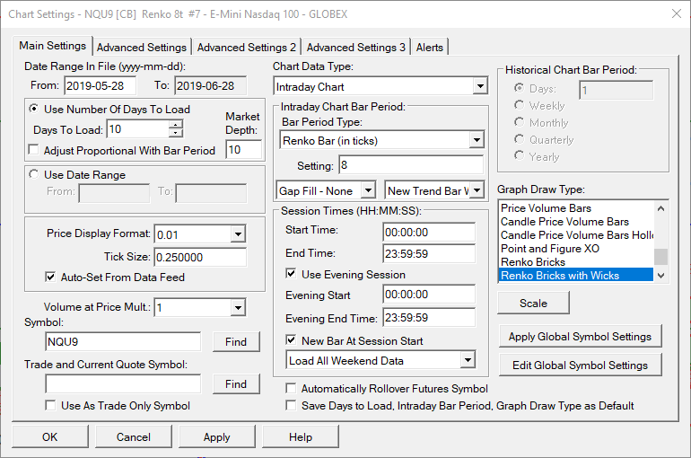

Hello Support,
I have had this problem for a while but lately it became substantially more exacerbated. SC is crashing if I am working with Renko charts. Initially I thought this may be caused by an extensive calculation necessary for the Renko format so I have cut down the number of days loaded to only 10 days (even though this substantial impacts my ability to do analyses on a longer period of time). This did not help. If I have Renko chart for NQ (or any other futures market) open in a higher format the platform is more or less stable. However, if I try to zoom in into a lower time frame on the same chart - Sierra Charts crashes and shuts down.
Example: NQ Renko chart of 8 ticks is more or less stable (almost never crashes) but switching down to 4 ticks Renko on the same chart almost immediately shuts the platform down.
I am attaching an image of my Renko chart configuration. Quick note: I am projecting the drawings on this Renko chart from another chart with a higher time frame but I don't think this is what 's causing a problem. Other charts with the same drawings projected are NOT crashing the platform. It is ONLY happening when I try to manipulate the setting of the Renko chart, specifically zooming in to a smaller timeframe or adding substantially larger number of days to load
