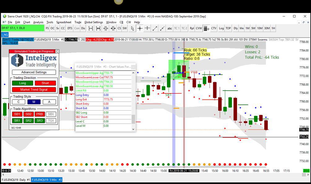

The software indicates it called for a stop loss to close the position at 7773.75. This stop loss was in place for the 15:20 candle which would have started at 15:15:01. Please see Jun21Exit.jpg attached.
The trade activity log indicates an exit instead at 7771.25 at 15:24:58. I reached the limit for attachments, so at the bottom is a cut/paste of the Trade Activity Log for the trade in question.
A 5-sec chart is also attached, with the candles from 15:15:05 until 15:25:20 (slightly after the actual exit) highlighted, and lines drawn at the expected exit price (7773.75) and actual exit price (7771.25). You can see that there were plenty of opportunities for the 7773.75 to have been executed, in fact almost from the moment the software moved the stop up to that level.

I'm so sorry. I didn't notice the tab you wanted. I have attached an Excel file with the stop order and fill activity. The same info is also shown below:

The stop order had a price of 7756.75 and never filled.:
Order 2019-06-21 15:09:59.290 [Sim]F.US.ENQU19 Simulated order accepted 40 40 Stop 1 Sell 7756.75 Open Sim1 Close 38 1
It was this market order which closed the position:
Fill 2019-06-21 15:24:58.296 [Sim]F.US.ENQU19 Trade simulation fill. Bid: 7771.25 Ask: 7771.75 Last: 7771.50 41 41 Market 1 Sell Filled 7771.25 1 Sim1 Close 41.1 7778.50 7771.50 SimpleBracket.twconfig
So as you can see, there was no such thing as any slippage here. As we said that is not even technically possible. If you have any questions about the trading activity contact the automated trading system provider. Also as a matter of policy we charge for these analysis, and we did not do that here. Next time will be charging 50 USD per hour.
