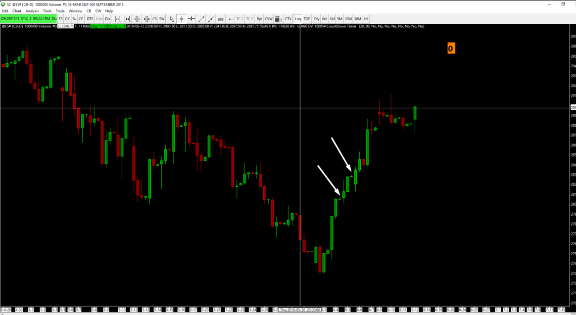

hi,
i am trying to use 1mil volume candles. In order to do that i define the session times as follows.
Start time: 23:00
End time: 22:00
No evening session.
The problem is that i am getting the following:
- One volume candle that starts at 23:00 (which is fine), right when the session starts as defined.
- Another one that starts at 0:00. This is not correct.
how can i fix this and have just one candle starting at 23:00 and ending once i have 1mil volume traded?
thanks a lot!
David
image1.PNG / V - Attached On 2019-06-17 11:06:16 UTC - Size: 44.29 KB - 461 views
image2.png / V - Attached On 2019-06-17 11:06:19 UTC - Size: 113.57 KB - 401 views

Anyway, we are not observing this issue:
http://www.sierrachart.com/image.php?Image=1560780411267.png (Updated screenshot. Disregard the duplicate September 2019 line at the end of the chart. We will take care of that. )
Therefore, the issue you are having would seem to be related to an IQ Feed out of order time stamping problem.

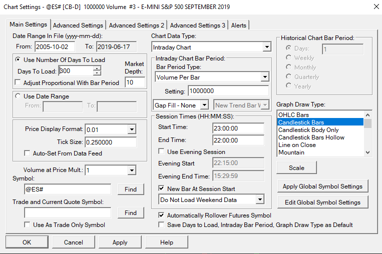

You also need to disable this option:
Chart Settings: New Bar at Session Start (Chart >> Chart Settings >> Session Times >> Intraday Chart Session Times menu)
