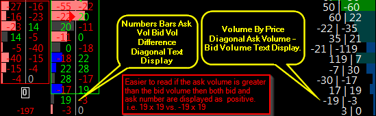

Hi Support Team,
On the Volume by Price study the Display Volume in Bars setting "Diagonal Ask Vol Bid Vol Difference" is a bit confusing as it's difficult to know if the diagonal volume comparison is negative or positive at the price level because the opposite diagonal calculation is the negative/positive of the same value.
Volume By Price Study: Display Volume in Bars
Would it be possible to either include a separate diagonal display type in the volume by price study similar to the numbers bars text display option "Ask Vol Bid Vol Difference Diagonal" which displays the text for the diagonal difference numbers as both negative or both positive based on the dominant bid or ask. The diagonal comparison on the numbers bars study is much easier to interpret than the diagonal comparison on the volume by price study when read from left to right.
Numbers Bars: Numbers Bars Text Types
Thank you for your consideration.
imageVBP vs Numbers Bars Diagonal Difference Text Display.png / V - Attached On 2019-05-26 20:58:17 UTC - Size: 16.3 KB - 1122 views

This has been added as an additional selection in the Display Volume in Bars Input for the Volume by Price study and is available in the current Pre-Release.
The name of the new option is Diagonal Ask Volume - Bid Volume. The only difference between this and the one above it in the list - Diagonal Ask Vol Bid Vol Difference is that the calculation is always performed as Ask - Bid, which results in the same values diagonally from each other, as opposed to negatives of each other.
