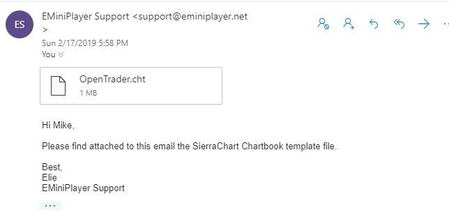

[2019-05-02 22:51:04]
mikeb029 - Posts: 25
They attempted to share the file with me via link in an email they sent me. See attached picture of how I received it. I had a heck of a time getting it into my Chartbook. And, obviously once there no charts contained within. Any other suggestions?
Thank you,
imageCapture.JPG / V - Attached On 2019-05-02 22:50:35 UTC - Size: 23.86 KB - 476 views
[2019-05-03 19:48:37]
So after you save that file, is the file size 1 MB?
[2019-05-04 15:42:34]
It is showing as 1.41MB when downloaded to my Downloads folder.
File size listed in my Chartbook as 18 B which is the same number listed for another chartbook that was shared with me by someone else that also appears to be empty.
What do you think is happening?
Thank you,
[2019-05-04 17:34:03]
Ok so it is getting successfully downloaded and then when you move the file to C:\SierraChart\Data , the file size will remain the same. It is not going to change when you open it in Sierra Chart through File >> Open Chartbook.
