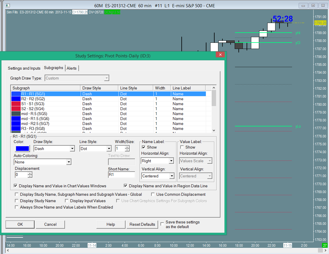

Why do the Daily Pivot study labels not appear (please see screenshot)?

Bruce Heubach - Posts: 16
If you view the screenshot, you see that I have selected to use the name labels on this study and yet they do not appear on the chart. My question was why do they not appear on the chart?
[2013-11-15 18:36:07]
Probably because of the study itself is not even visible. You have highlighted the R1 Subgraph, but we do not even see that on the chart. At least it is not clear to us. Once again, what may be clear to you, is not to us because we are not setting up the studies. We do not know exactly what you are doing.
The study appears on the screenshot I sent. The reason you don't see it is due to the absence of labels, the lines are visible. After reviewing your technical studies reference for this study, I was not able to resolve my issue. I have been using SC for a while now and have found it quite useful, but truthfully it is difficult to recommend it when time after time I see similar traders' requests for help and support folks are too busy telling them they're too busy to help, like now. No need to respond as I know you're busy. Thank you anyway.

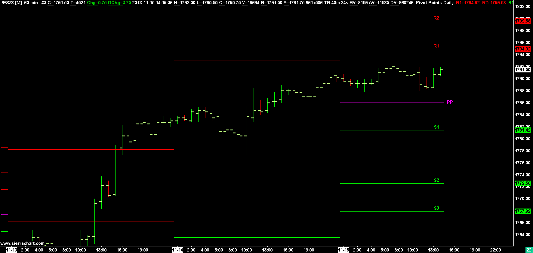

Not sure if it helps, but here is an image with the study with labels:
http://www.sierrachart.com/image.php?l=1384543177617.png
The PP label has been set to be Right aligned and Centered just like you have set. This was a new instance of the study added to the chart. The labeling does work properly.

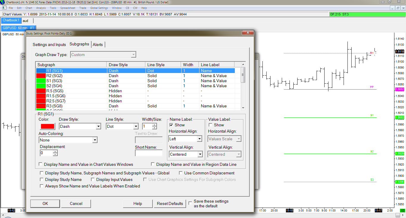

Bruce, try removing the Pivot study and adding it again. I did see a problem too (no labels after scrolling), when adding the Pivots study to a new chart. After removing it and adding it again, I couldn't reproduce this behaviour though!?
SC you might want to look into this. There might be a problem with the Pivots-Daily study. I'm not having a problem with my existing charts, but when adding the study to a new chart, there seems to be some strange behaviours. E.g. when you choose the Horizontal Align Name Label "Left", it doesn't align left (s. screenshot for R1).

Thinking about this some more, the best way for us to help with the problem, is to get a Chartbook with a single chart that demonstrates the issue. We should have asked for that earlier. Because otherwise, we don't know what the problem is. The Chartbook can be attached here.
When you choose Left for the horizontal alignment, it does not mean far left. It means left of the right side of the Subgraph line. To actually get it on the far left you need to choose Left Edge.

tobi - Posts: 351
Regarding Left for the horizontal alignment, I see now. Thanks for pointing that out.
My understanding (sofar) was, that Left means on the left side of the pivot line, just as Right aligns the Name label on the right side of the pivot line.

[2013-11-16 23:59:26]
Documentation has been updated with descriptions for these different horizontal Alignment label options:
http://www.sierrachart.com/index.php?l=doc/doc_ChartStudies.html#NameValueLabels
We also want to add, that the label functionality is very simple and reliable. If a label is not visible, there must be a simple explanation for it. Either the Subgraph is not within view of the price range of the chart, there is not enough fill space displayed or the study is just not visible.
