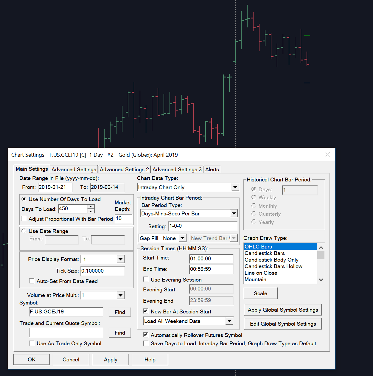

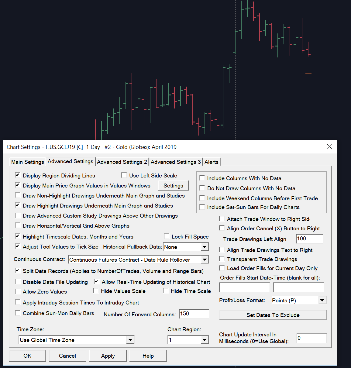

Hello, would you please help me with the following problem.
I am trying to find how to fix a gap with a Gold future contract. I was trying to solve the problem with many ways:
- deleting and reloading data for the last 2 months;
- changing rollover rule;
- changing days to load;
But nothing helped. The time zone I am living in is +3 UTC (based in Moscow), I have checked the session time as well. Now I am confused how to fix a gap.
Some screenshots are attached.
imageProb 1.png / V - Attached On 2019-02-14 12:43:16 UTC - Size: 86.85 KB - 455 views
imageProb 2.png / V - Attached On 2019-02-14 12:43:22 UTC - Size: 89.46 KB - 366 views
imageProb 3.png / V - Attached On 2019-02-14 12:43:26 UTC - Size: 86.36 KB - 388 views

[2019-02-14 18:54:07]
We do not know what gap you are referring to. And also the dates you mention are at a future point in time.
[2019-02-15 08:04:19]
Vladislav Kravchenko - Posts: 39
Ok, I have made a mistake.
The exact dates are between 28 and 29 January.
Would you please tell me how to avoid gaps in the future and which rollover rule is the most accurate?
[2019-02-15 18:14:11]
Okay so that particular price gap can be corrected by using one of the back adjusted continuous futures contract rollover options:
Continuous Futures Contract Charts: Continuous Futures Contract Rollover Options
