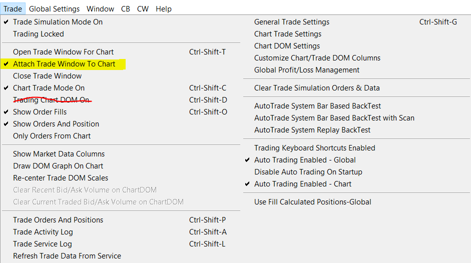

Hello team,
From this documentation, it says "When a Trade DOM window is attached to the main Sierra Chart window, the standard Normal Select pointer will always be used. ":
Chart Drawing Tools: Controlling the Type of Pointer Displayed When Using Drawing Tools
I have the trade options as in the attached file and I still see the Normal Select pointer (not the Precision Select). Is that configuration ("Attach Trade Window To Chart") considered as a DOM window? If you are manually trading is not that cool to use the Normal Select :(
Thanks!
imagetrade_config.PNG / V - Attached On 2019-02-09 20:32:18 UTC - Size: 39.56 KB - 361 views
[2019-02-10 20:50:15]
No.
