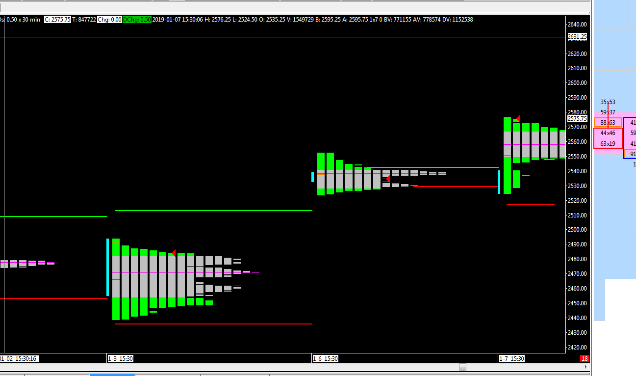

[2019-01-12 11:28:55]
User919585 - Posts: 6
Thanks for your answer. Timezone is set to Brussels but still I have no fridays on my TPO
See also attachment
Already thanks,
Anita
imageTPO timezone.PNG / V - Attached On 2019-01-12 11:28:09 UTC - Size: 34.01 KB - 389 views
[2019-01-13 17:48:33]
Make sure the chart is set to load weekend data:
Chart Session Times: Load Weekend Data Setting (Chart >> Chart Settings >> Session Times)
