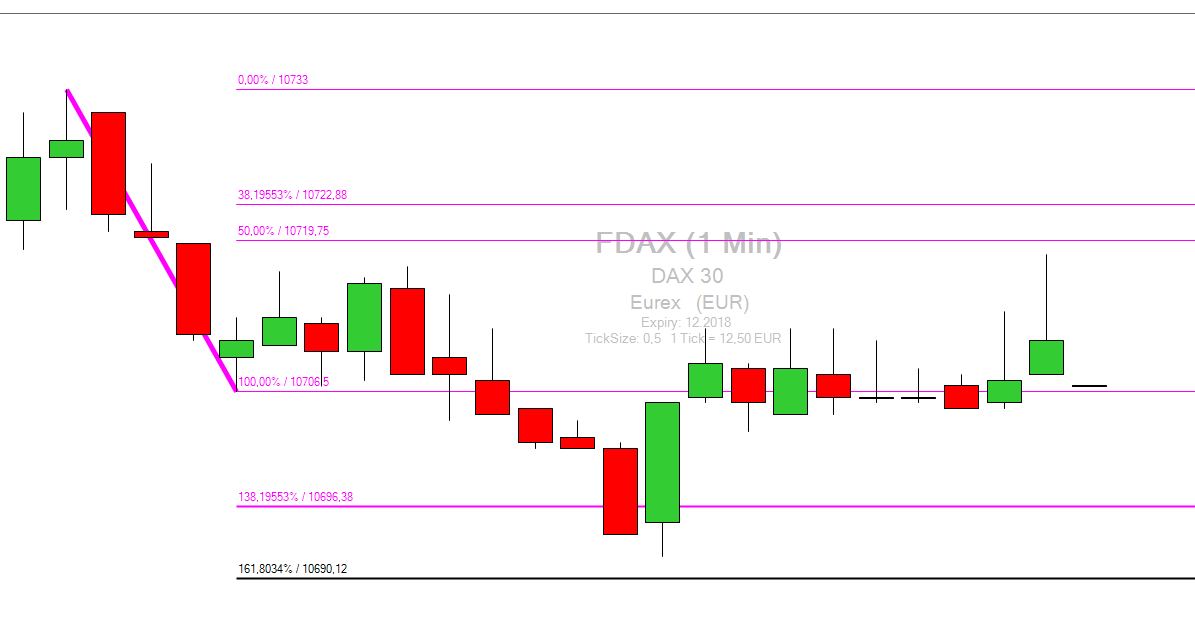

I think the Tool "Price Retracement" needs a setting, where the User could choose whether he want's to use the automatic detection of "down / up sloping".
The Problem is that you cannot freely choose at which Price level the 0% (start of the price move) should be, and on which Price Level the 100% (end of the price move) should be, because of the automatic behaviour in Sierra described bellow:
If the line is down sloping, then the retracement lines will move upward starting from 0% at the bottommost point and the percentages will increase from this bottommost point.
If the line is up sloping, then the retracement lines will move downward starting from 0% at the topmost point and the percentages will increase from this topmost point.
As stated here:
Chart Drawing Tools: Price Retracement (2 point) | Price Expansion (2 point) | Price Projection (3 point) Tools
What i want to achieve is the following behaviour and are Crucial to have an Edge with Fibo-Retracements:
Problem-1-in-Sierra:
If i set the Retracement as shown in the picture "fibo_retracement_down.png" in Sierra, then the retracement lines will always move upward and the User has no chance to change this.
Problem-2-in-Sierra:
If i set the Retracement as shown in the picture "fibo_retracement_up.png" in Sierra, then the retracement lines will always move downward and the User has no chance to change this.
Also the SWAP Anchors feature does not solve this, which is also strange.
Could you implement / disable this automatic behaviour in Sierra please - so that the User has freedom how to draw the retracements ( like shown on my attached pictures).

We have never had anyone ever ask about this before, at least we cannot remember and we are not in a position to be able to be able to support this anytime soon. We really just cannot help.
Date Time Of Last Edit: 2019-01-01 05:16:47
[2018-12-13 23:43:46]
Now one thing you can do is change the slope of the line in order for the retracement levels to function opposite of the way they currently do.
And then you can set the Chart Values tool to be active with other tools through Global Settings >> Tool Settings >> Chart Values and use the horizontal chart values line to assist with determining the price level you want to set the endpoint at in relation to a bar high or low.
Date Time Of Last Edit: 2018-12-13 23:44:55
[2018-12-13 23:45:54]
Or possibly we could just add an option to allow the direction to function in the opposite way but that would be an additional cost if you want us to develop this.

Update to pre-release 1858 following these instructions here:
In the Global Settings >> Tool Configurations >>Price Retracement tool dialog there is a new Option named:
Reverse Percentages
That can be enabled and will apply to the next drawn retracement drawing and can be modified on an existing drawing.
Let us know if that meets your requirements. If there any issues or limitations just let us know.

Quick Test: Looking very good so far!!!
I will test it intensive in the next days, weeks and report any issues or limitations.
Best regards
[2019-01-19 09:26:52]
User722856 - Posts: 81
Dear Sierra,
After intensive Tests I confirm that the tool is working Superb.
No issues or limitations found.
