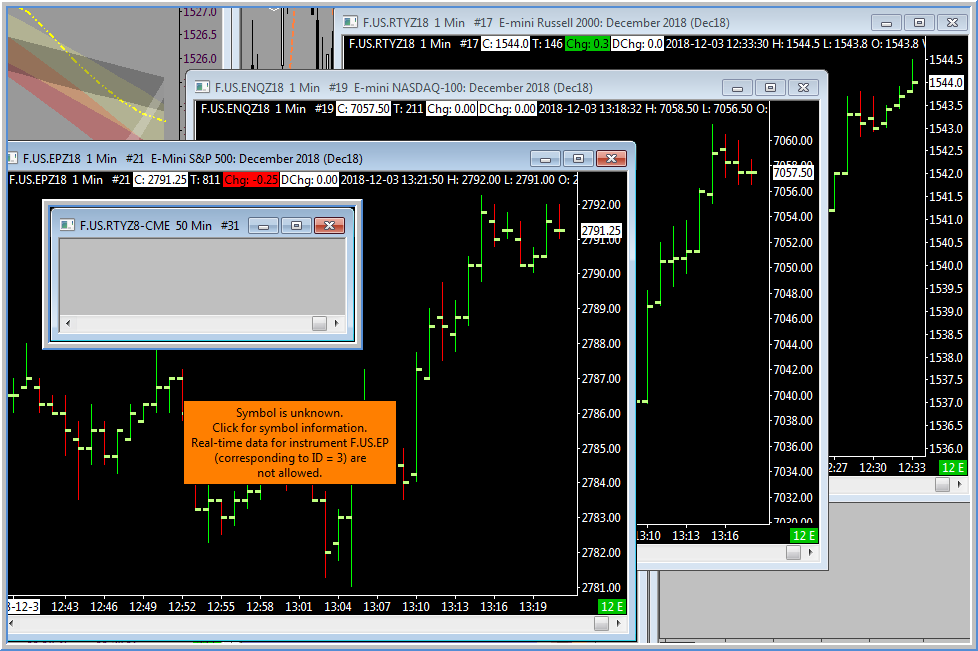

I can load new charts but when I update legacy charts to new symbols, I get no response & no data. Any suggestions? (See png clip, plus log.)
image2018-12-03_Charts with data load errors.png / V - Attached On 2018-12-03 20:46:40 UTC - Size: 69.94 KB - 395 views

[2018-12-03 22:14:10]
Could you just restart Sierra Chart and enable the Force Login option.

TraderTen - Posts: 80
Ok, it looks like that did the trick. However, I need to watch the feed for awhile to verify it is real time, as it is evening session, and ticks aren't coming through as often. But that is real progress. It even enabled me to change the legacy charts (one so far) to the new symbols and get updated data.
So, looks like I should do this for every log it, as it appears to not save this election upon shut-down?
[2018-12-04 01:34:11]
No you just need to do that once. You are all set.
OK, but on loging on this AM, while log0n & Symbols work, however, the data still has issues: Specifically: charts update on logon, then system logs off and no data for 8 minutes, then logon/update, then logoff for another 8+ minutes. Any ideas.
See log attached for this mornings logon sequence. (I tried to attach log but your system would not allow it).
[2018-12-05 01:42:28]
We do not see any Message Log attached or any log which has been sent from your account. Follow the instructions here:
[2018-12-05 03:45:36]
OK, here is an updated one: THE PROBLEM IS CHART IS UPDATED TO CURRENT TIME, BUT THEN SHUTS DOWN, SO GET NO REAL TIME DATA, WHICH IS WHAT I SIGNED UP FOR IN THIS EXCHANGE PACKAGE.
