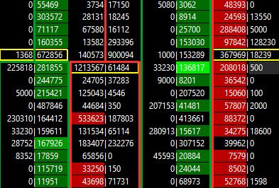

Thank You for Yor reply, I did the update now. I am referring to the
1) Number bars calculated values Study
See picture in attach
I am struggling to read this number correctly, A thousand separator would be very helpfull
2) in the number bars study, bidvol x askvol study,
It would be nice to have the possibility to abbreviate like you can see and do it in the Times and sales windows
for example 100000 to 100K ect... a thousand separator would help too. Its ingeneral a question to make large numbers more readable.
imageThousand separator needed.jpg / V - Attached On 2018-12-04 13:18:36 UTC - Size: 33.65 KB - 458 views
imagenumbers bars difficult to read.jpg / V - Attached On 2018-12-04 13:22:19 UTC - Size: 102.95 KB - 467 views
[2018-12-04 18:34:43]
For the Numbers Bars study you need to set this Input to Yes:
http://www.sierrachart.com/index.php?page=doc/NumbersBars.php#Input_UseLargeVolumeNumberFormatting
We will make sure we add the same input for the Numbers Bars Calculated Values study
[2018-12-05 13:19:06]
User661434 - Posts: 27
Awesome, I have adjusted it for the number bars, it gives me a lot of comfort now....
Thanks, I am looking foraward when these settings would be available in the Numbers Bars Calculated Study too, thanks a lot....

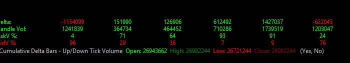

[2019-02-02 15:16:05]
Hi, Regarding the Numbers Bars Calculated Study, would it still be possible to make the Rounding to thousand units possible?
My 'table' is pretty unreadable when high numbers occur - see example image in attach
(just like in the - fantastic - number bars itself, where the Rounding is possible)
I am sure that a lot of people would be helped with this function
Thanks again for reading my stuff :D
imagenumber bars table.JPG / V - Attached On 2019-02-02 15:13:14 UTC - Size: 20.7 KB - 346 views
[2019-02-02 17:04:07]
Yes, this is still on our short list to get done. We have just been busy with other tasks. We hope to get to this in the next few weeks.
