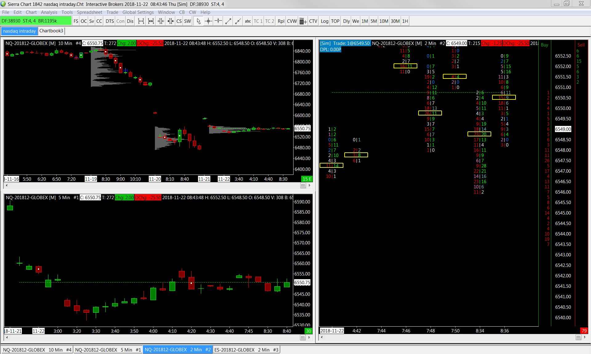

Dear Gents,
I would like to ask you for help. I am new into Sierrachart. I have a problem with the intraday data being loaded incompletely in the chart, as seen in the attached screenshot. During replay, numbers bars showing only zeroes some time.
I use Interactive Brokers as trader, I have allowed support for Sierra Chart data feeds. I have service package 5,
I have activated: Full CME Group (CME, CBOT, COMEX, NYMEX) with Market Depth for nonprofessional Trading accounts
Market Depth Included:
Could you give me any advice how to get correct graph?
Best Regards,
JJtrader.
imagesierrachart snapshot.PNG / V - Attached On 2018-11-22 15:05:59 UTC - Size: 125.23 KB - 630 views
imagesierrachart snapshot numbersbars.PNG / V - Attached On 2018-11-22 15:06:12 UTC - Size: 99.48 KB - 592 views

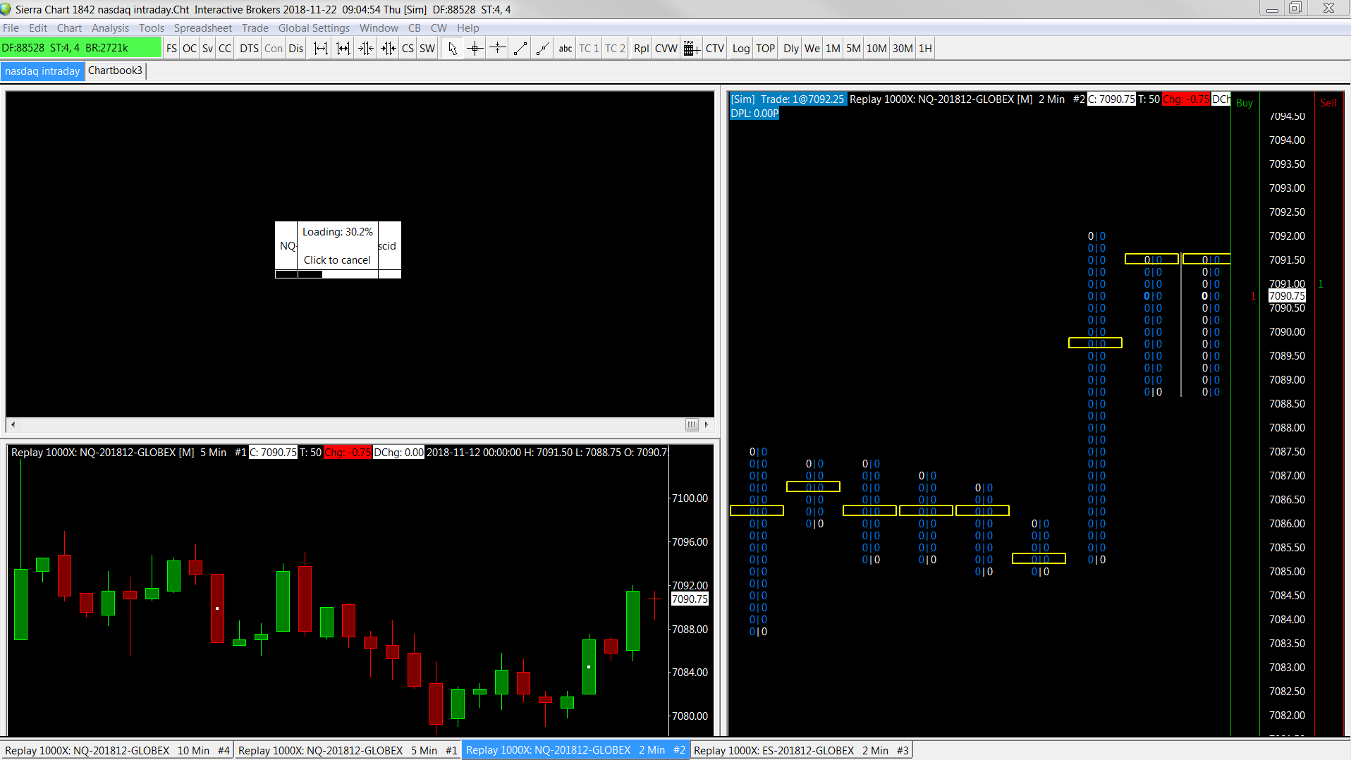

thank you for your reply.
I pressed "Edit / Delete all data and download 2 times, it gives me the same result.
This time, the bars are loaded continuously, but there are no historical numbersbars loaded at all.
Regards,
JJtrader.
imagesierrachart snapshot2.PNG / V - Attached On 2018-11-23 08:56:08 UTC - Size: 141.95 KB - 471 views
[2018-11-23 17:27:48]
We can see based upon that chart image, that you are not connected to the Sierra Chart Exchange Data Feed. Is Sierra Chart connected to your live Interactive Brokers account?

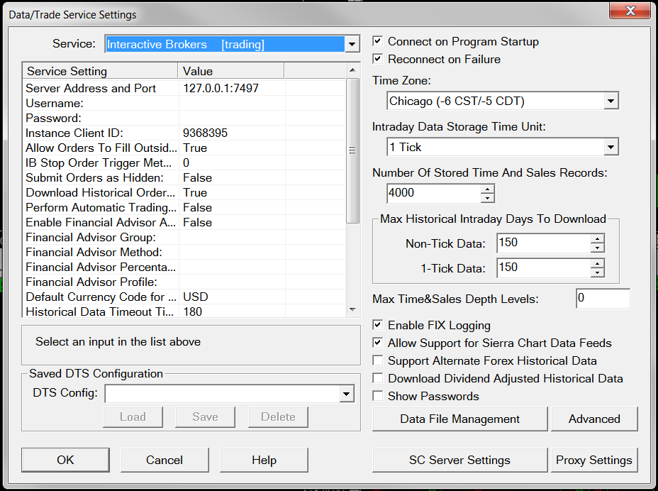

Can you tell me, how you can tell whether I am connected to the Sierra Chart Exchange Data Feed?
In attached image, I am sending the Data / trade service settings.
Allow Support for Sierra Chart Data Feeds is clicked,
Chosen service is : Interactive Brokers [trading]
Can you advise me what should I do differently?
Best Regards,
JJtrader.
imageSierrachart snapshot 3.PNG / V - Attached On 2018-11-26 15:56:43 UTC - Size: 67.33 KB - 448 views
[2018-11-26 18:02:22]
We can tell because there is no [M] after the symbol at the top of the chart.
Looks like you are connected to a demo or paper trading account.

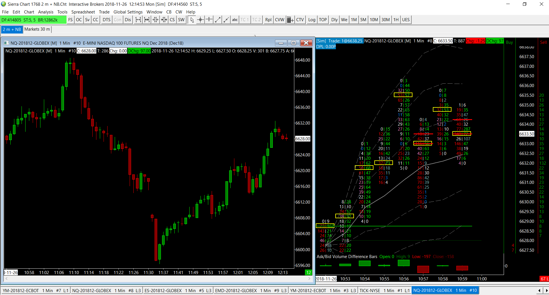

No idea - Now it shows the [m] as seen in attached image.
Unluckilly, NQ-2018-12-GLOBEX desn´t load more than today 10:58 - 12:13.
Deleting and reloading the data gives me the same result.
imagesierrachart 4.PNG / V - Attached On 2018-11-26 18:18:48 UTC - Size: 137.43 KB - 424 views
[2018-11-26 19:18:57]
Follow the instructions here:
