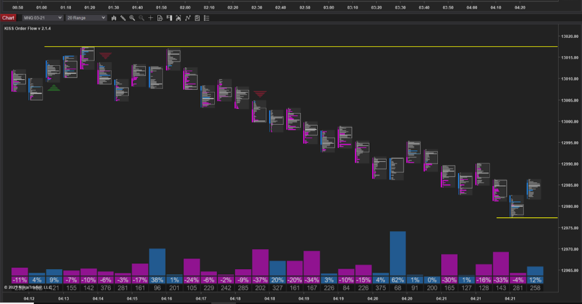

Is it possible to convert Ask/Bid volume difference bars into histogram and calculate the numbers as percentage rather than raw contracts traded as in KISS OF of Ninjatrader
imageKISS-NINJA.PNG / V - Attached On 2021-03-03 05:32:51 UTC - Size: 135.56 KB - 703 views
[2021-03-03 06:19:43]
You can modify the source code and do what you require. Refer to:
How to Build an Advanced Custom Study from Source Code
