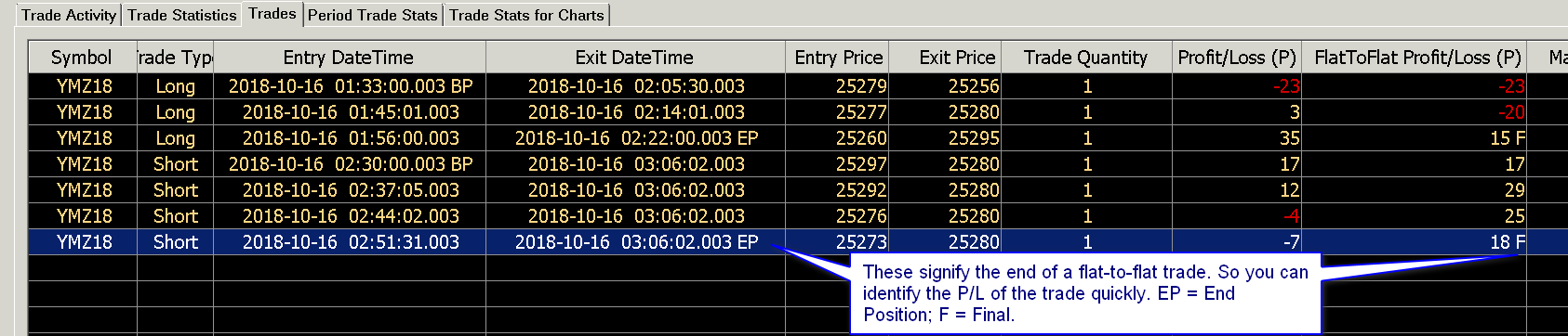

[2018-10-19 20:58:50]
See the attached screenshot to easily identify the final profit/loss of a Flat to Flat trade.
There is also a command on the Edit menu of the Trade Activity Log to remove those text indicators at the end of the field.
For the latest development use version 1825.
Date Time Of Last Edit: 2018-10-19 21:38:12
