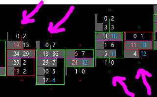

Hi Team,
The Ask Volume Bid Volume Difference Text font is extremely small since v.1807 update.
I have checked the Global and Chart graphics settings, and all fonts appear "normal" size.
Please see screenshot which shows the tiny Ask Volume Bid Volume Difference Text (one study paints above bar, the other duplicate below bar) vs the Numbers Bars text size.
Any suggestions?
Thanks in advance!
Date Time Of Last Edit: 2018-09-18 10:23:20
imageCapture.PNG / V - Attached On 2018-09-18 10:22:24 UTC - Size: 8.93 KB - 439 views
[2018-09-18 13:06:42]
You need to adjust the Width/Size setting for the Subgraph of that study:
Chart Studies: Subgraphs Tab >> Line Width

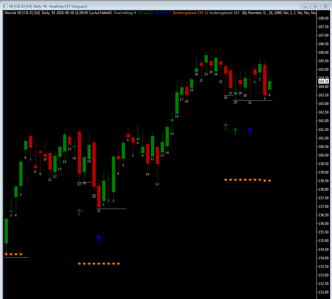

[2018-09-19 11:20:16]
Ufo de Jager - Posts: 16
The study is: "Spreadsheet System/Alert". And then the first row (subgraph) I use Draw Style "Value On Low". Picture "Sierra01.png" is version 1808_64, picture "Sierra02.png" is version 1803_64
imageSierra01.PNG / V - Attached On 2018-09-19 11:14:45 UTC - Size: 42.17 KB - 449 views
imageSierra02.PNG / V - Attached On 2018-09-19 11:14:52 UTC - Size: 46.43 KB - 535 views
[2018-09-19 11:23:12]
You just need to increase the Width/Size of that particular Subgraph. We have verified that does work properly. It does not surprise us there is a difference, you just need to adjust the size appropriately. This is all.
Date Time Of Last Edit: 2018-09-19 11:26:06
[2018-09-19 11:35:37]
I did, but only till size 3. In previous versions, that would make the text really big. I just tried 10 and now it's bigger. So the size adjustment is now the same 'method'/format as in spreadsheets and text editors. Thanks!
[2018-09-20 01:19:30]
Dema - Posts: 42
Thanks team, confirming that increasing that setting (from default 1 to 10) worked perfectly.
[2018-09-20 01:57:41]
Okay this also confirms, that there was not proper translation of that value. That is meant to be a point size converted to what is called a logical height.
We did a recent review and reorganization of this.
