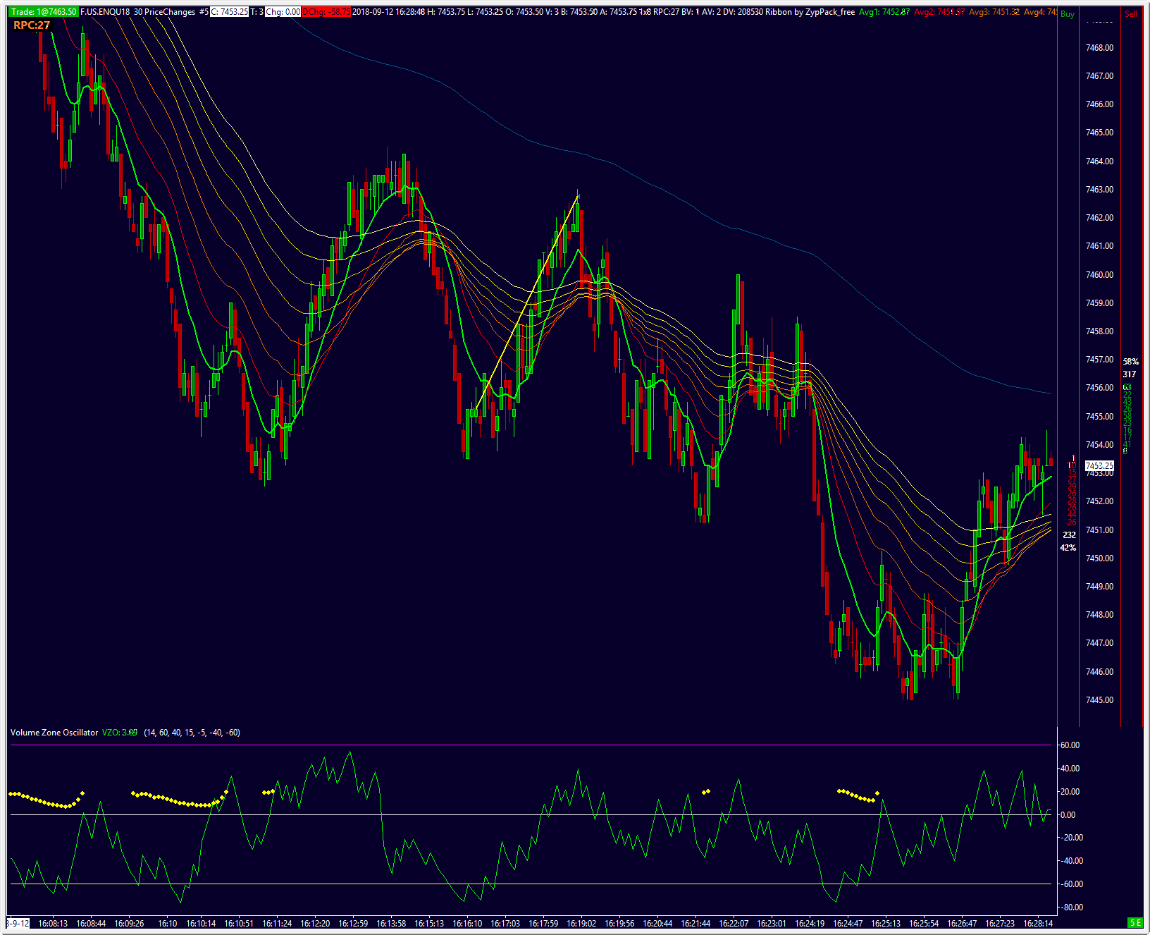

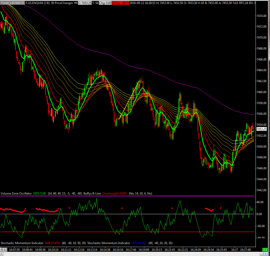

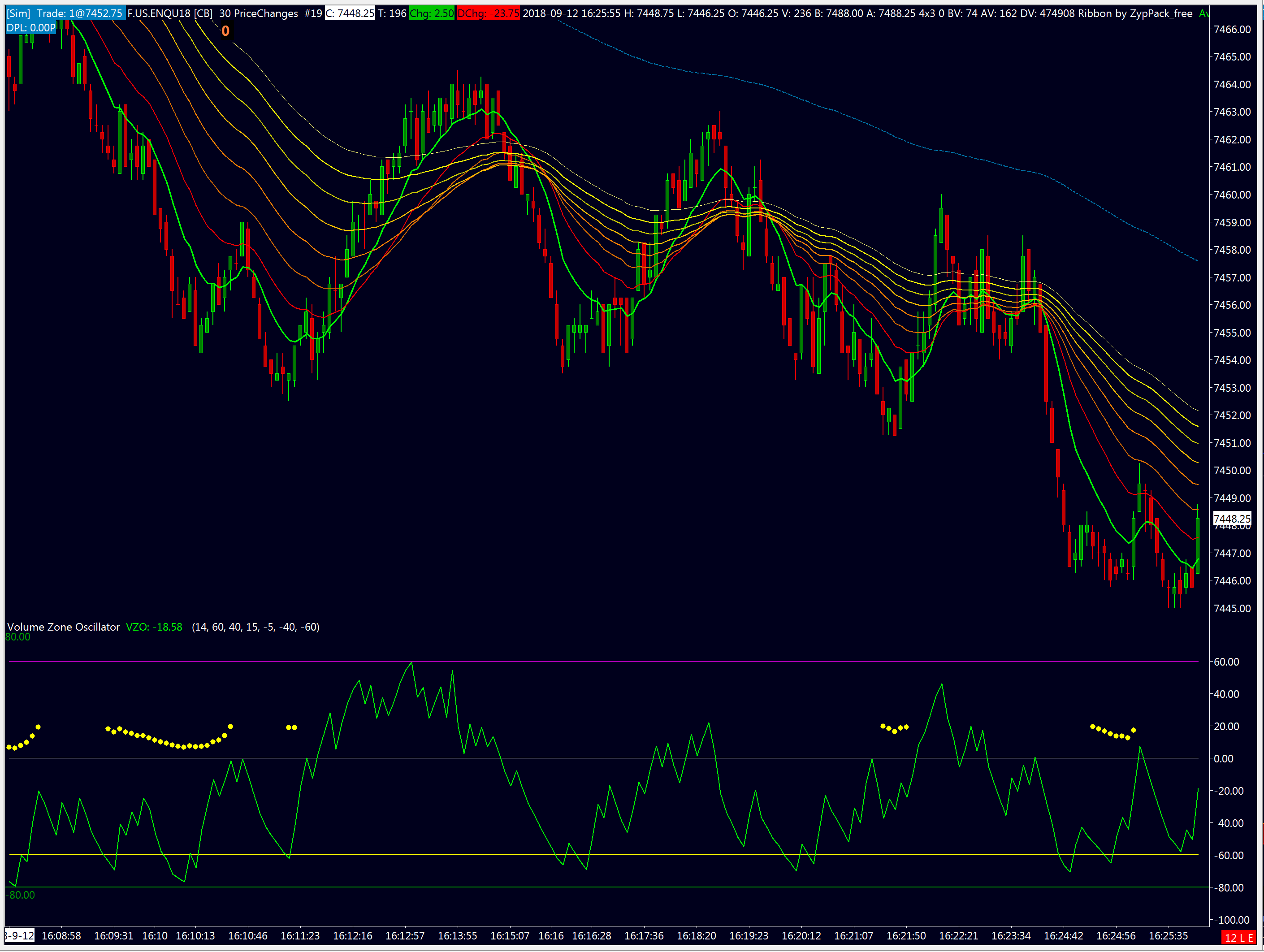

can you please advise me where the SierrChart error is that it misrepresents the Price Changes chart on different PCs? In my work I have a graph drawn somehow, I will come home SierrChart - I get the data and the chart at the same time looks different. A friend who has the same broker, the same data (CQG), has a completely different plot. Where can be a bug ??? Interestingly, for example, at the Reversal chart or Renko chart it sits and the charts are fine. Check the enclosed screens. Everything is beautifully seen on the Volume Zone Oscillator, where there are really great differences due to the otherwise drawn candles in the chart.
thank you for answer

[2018-09-13 04:46:48]
These types of charts are going to be hard to get an exact match. You are going to need a perfect data feed . Therefore, you need to use the Sierra Chart Exchange Data Feed:
We will not help with CQG data.
Set Sierra Chart to a Tick by Tick Data Configuration. Follow the instructions here to do this:
Make sure the Chart Settings are exactly an exact match between each chart and also that the time zone is the same:
Chart Settings
Date Time Of Last Edit: 2018-09-13 04:47:12
