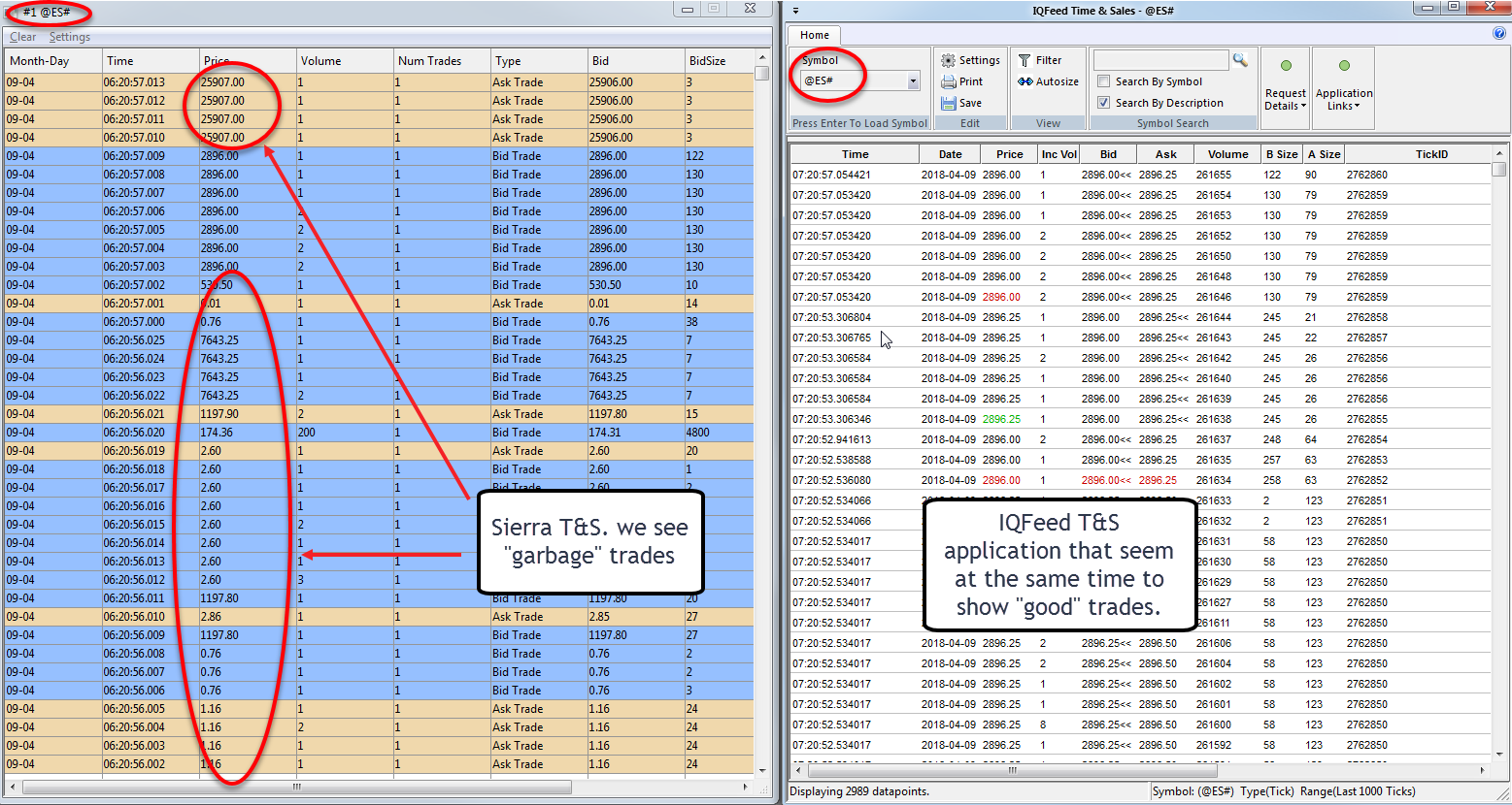

I may have the same pb.
Something does not work anymore on SOME of my instances, but not all, with the real time update of charts of Sierra+IQFeed recently.
I tried to clean all my scid, load on one machine or multiple instances. But real time update seem to have a problem.
When opening SC T&S I see orders that seem to be garbage or coming from other markets. When opening the IQFeed T&S in parallel, it seems IQFeed tool does receive the right data.
I use IQFeed 6.0.0.5 with SC 1795.
Enclosed-by screenshot.

FWIW : I had similar filitered erros. I rolled back to 1781 and it seems all my problems are solved.

We are looking into this now.
[2018-09-04 17:42:07]
We have this resolved and we will have a new release out in about 20 minutes.
[2018-09-04 18:11:55]
This issue is now resolved in the latest revision of prerelease 1797. Update to the "Prerelease" following these instructions here:
