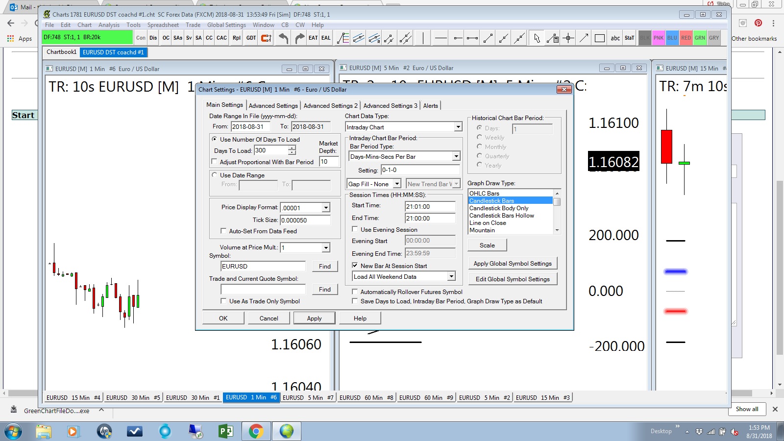

I just downloaded Version 1781 and I am not able to get historical data. The date range is only for the current day, today. If I change the date and click Apply or OK, it just changes the date back to today's date and no new data is downloaded. I have uploaded a copy of the screen.
Before I did the upload, I had to delete the old version (1717). When I tried to update that version it would not work, so I deleted it, downloaded the executable file and installed the current version.
Thanks.
imageGC.jpg / V - Attached On 2018-08-31 20:56:05 UTC - Size: 375.96 KB - 372 views

HD Request # 3 | Received 0 records from 00:00:00 to 00:00:00 (0.0 seconds) and wrote 0 records for EURUSD | 2018-08-31 15:38:00
HD Request # 3 | Completion time: 20s | 2018-08-31 15:38:00
HD Request # 4 | Downloading Intraday chart data for EURUSD to the file EURUSD.scid. Service: fxcm | 2018-08-31 15:38:00
HD Request # 4 | Download start date-time: 2018-02-26 14:37:59.000 | 2018-08-31 15:38:00
HD Request # 4 | Using server: ds4.sierracharts.com port 10149 | 2018-08-31 15:38:00
Socket (12) | Creating socket. | 2018-08-31 15:38:00
Socket (12) | Connecting to IP: 192.81.56.146. | 2018-08-31 15:38:00
Socket (12) | Initiating close of socket by core. | 2018-08-31 15:38:20
HD Request # 4 | Error downloading historical Intraday data for EURUSD. Timeout error connecting to server. | 2018-08-31 15:38:20
Socket (12) | Closed. | 2018-08-31 15:38:20
Historical data download thread signaled to stop. | 2018-08-31 15:38:20
HD Request # 4 | Received 0 records from 00:00:00 to 00:00:00 (0.0 seconds) and wrote 0 records for EURUSD | 2018-08-31 15:38:20
HD Request # 4 | Completion time: 20s | 2018-08-31 15:38:20
HD Request # 4 | Intraday data download complete for EURUSD. Unique request ID: 1 | 2018-08-31 15:38:20
Removed historical data download ID 1 | 2018-08-31 15:38:20
Real-time Intraday chart data file updates started for EURUSD | 2018-08-31 15:38:20
Opened cached Intraday file: C:\GreenChart\Data\EURUSD.scid | 2018-08-31 15:38:20
Intraday chart data file opened for EURUSD | 2018-08-31 15:38:20
[2018-08-31 23:40:40]
Yes that is the issue. Refer to this section here for instructions for this issue:
Historical Intraday Data (Missing Data / Download Errors / Viewing More Data): Error when Downloading Historical Intraday Data from the Sierra Chart Historical Data Server
Date Time Of Last Edit: 2018-08-31 23:40:59
