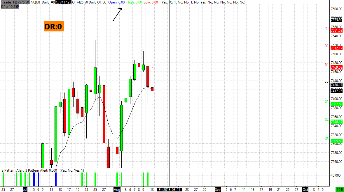

The Daily OHLC shows on all time frames except for daily. How can I fix this?

StevenCaleb - Posts: 14
http://www.sierrachart.com/image.php?Image=1534191121199.png
[2018-08-14 21:54:57]
Check the Number of Days to Calculate input with the Daily OHLC study. You will need to increase that.
[2018-08-15 14:16:35]
I increased that but it didn't help. I tried several different #s of days back. Regardless I still had the 0 readings as in the image I posted.
[2018-08-15 17:13:24]
You are adjusting the wrong setting. The Input is named "Number of Days to Calculate".
[2018-08-16 20:43:42]
No, I tried both. I still get 0s.
[2018-08-16 21:11:54]
There still must be a problem with the Input settings. Follow the instructions here to reset the study to default and then remove it and add it again:
Chart Studies: Resetting Default Study Settings For an Individual Study
[2018-08-18 11:14:28]
That got it working. But now it shows different OHLC numbers on the daily than my 5 minute chart. I noticed in chart settings when on daily, the seesions times are blanked out. Can this be fixed?
