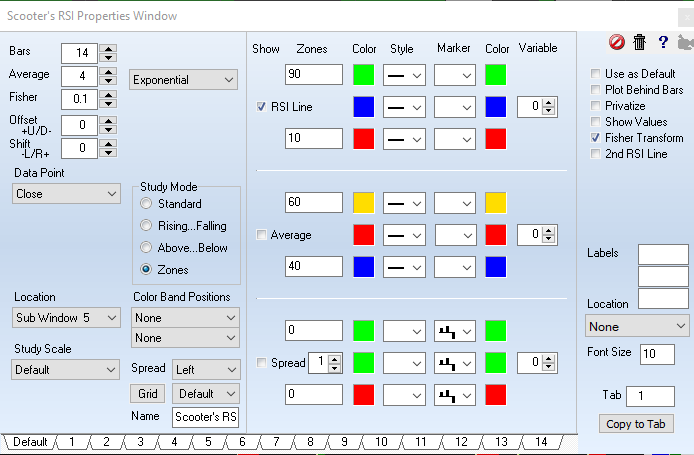

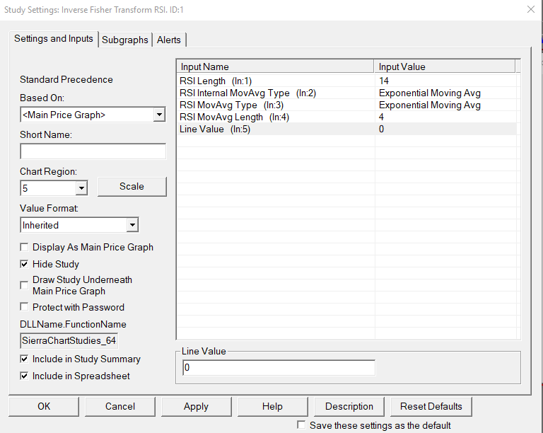

I'm switching from another charting software to SC and am in the process of recreating the indicators. I have an RSI with IFT in my original software (screenshot below - RSI properties.png) and found a similar study in SC but not sure where to put the Fisher field value in SC (sc.png) (0.1 - if I increase it to 0.2 it is less smooth), any ideas how to get exactly the same properties of the study, thanks.

[2018-07-26 18:20:54]
That setting is not supported. Do you know how it is used in the formula for the calculation?

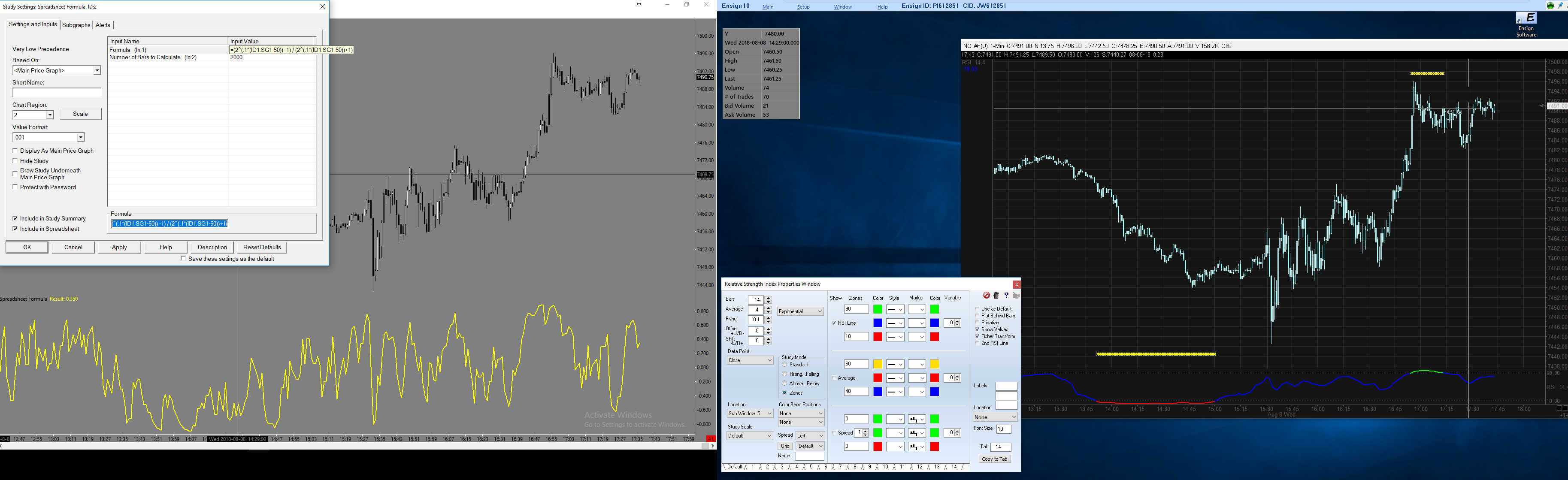

User718694 - Posts: 25
Well, it doesn't look the same. Now, another question I have is which Draw Style I should use in Color Bar Based on Alert Condition study to get an indicator condition drawn similarly as that yellow bar at the top and bottom.

[2018-08-08 20:57:07]
John - SC Support - Posts: 48028
With regards to the Fisher Transform, we notice that you probably have to use the RSI Average, rather than just the RSI. This is Subgraph 4 in the RSI study. That will smooth out the data substantially.
With regards to the Color Bar Based on Alert Condition, we do not have an exact match to what you are looking for. Our recommendation to get something similar is to use the Draw Style of Point on High and then change the Width/Size to something around 5 (play the number to find a value that works for you). This will place a point above the bars where the alert condition is true.
