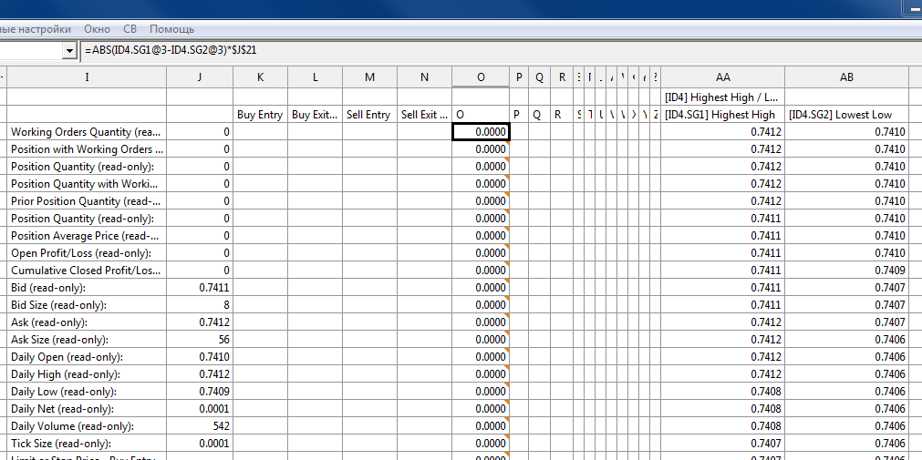

[2018-07-30 05:20:15]
2garin - Posts: 189

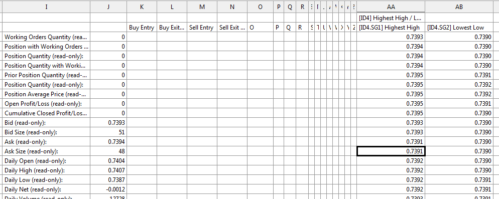

5. The Spreadsheet System for Trading table contains a Highest High / Lowest Low Over 4 Bars study (columns AA and AB).
How to determine (record for intermediate calculations) the value of the PriceRange of the last 4 bars and the PriceRange of the previous 4 bars (do I need to add the Highest High / Lowest Low Over 8 Bars to the table)?
image5.png / V - Attached On 2018-07-30 05:19:33 UTC - Size: 30.22 KB - 646 views
[2018-07-30 14:17:01]
Sawtooth - Posts: 4361
5. With the Length set to 4, the price range of the last 4 bars is the difference between AA3 and AA4. To calculate that, use this formula, for example in O3:
=ABS(AA3-AA4)
However, the preferred way to reference a study's output is to use this syntax:
Working with Spreadsheets: References to Study Subgraph Columns when using the Spreadsheet Study
=ABS(ID4.SG1@3-ID4.SG2@3)
This is the difference in points. To calculate the difference in ticks:
=ABS(ID4.SG1@3-ID4.SG2@3)*$J$21
To calculate the difference of the previous previous 4 bars, use the OFFSET function referencing O3, for example in P3:
=OFFSET(O3,4,0)

[2018-07-30 22:58:12]

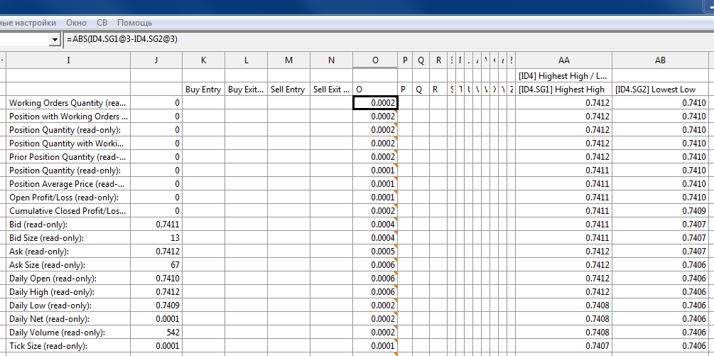

2garin - Posts: 189
Count the range in the ticks did not work.
imagepoints.png / V - Attached On 2018-07-30 22:56:58 UTC - Size: 43.64 KB - 606 views
imageticks.png / V - Attached On 2018-07-30 22:57:08 UTC - Size: 44.13 KB - 598 views
[2018-07-30 23:18:10]
The range in ticks will be very small for the symbol you are using.
-Highlight column O by clicking on the O at the top of the column.
-In the main menu, go to Spreadsheet >> Number Format
-Change the format to 0.000000001

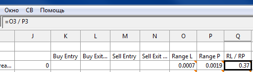

2garin - Posts: 189
7. Division of two cells is correct?
8. The ratio of the two cells is recorded correctly?
imagedivision.png / V - Attached On 2018-07-31 01:49:58 UTC - Size: 6.7 KB - 631 views
imageratio.png / V - Attached On 2018-07-31 01:50:05 UTC - Size: 8.11 KB - 575 views
[2018-07-31 02:44:55]
7. This is a valid division formula, and it is the ratio.
8. This is a valid boolean formula, and it will return a 1 if TRUE, and a 0 if FALSE.

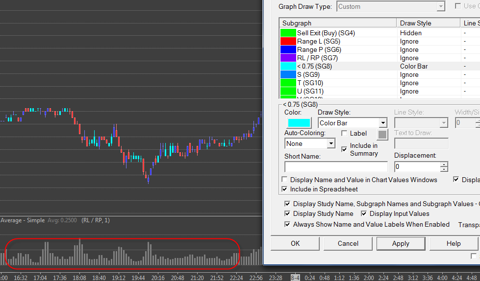

9. How to build a bar graph on the chart from the results of calculating the column Q?
10. How to mark bars satisfying the condition <0.75?
imageoutput of bars.png / V - Attached On 2018-08-03 00:15:44 UTC - Size: 2.96 KB - 569 views
[2018-08-03 00:49:24]
9.
Add the Moving Average - Simple study
- set the 'Based On' to the spreadsheet study
- set the 'Chart Region' to the one where you want the bar graph
- set the 'Input Data' to Q
- set the 'Length' to 1
- On the Subgraphs tab, set the Draw Style to Bar
10.
On the Subgraphs tab of the spreadsheet study's settings, set the Draw Style of R(SG8) to Color Bar.

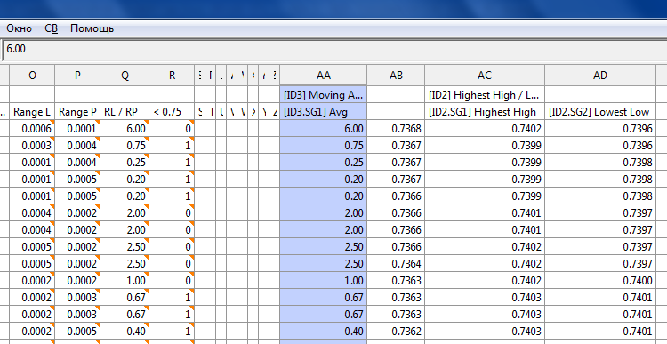

[2018-08-03 02:27:22]
2garin - Posts: 189

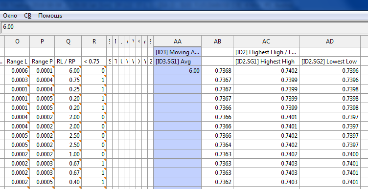

9. Add the Moving Average - Simple study
Why are the values in column Q different from the values of the indicator?
For what the column appeared in the table AB?
image9.png / V - Attached On 2018-08-03 02:26:20 UTC - Size: 40.03 KB - 569 views
[2018-08-03 03:25:53]
Go to Spreadsheet >> Recalculate All Formulas
or go to Chart >> Recalculate
Column AB has left-over data when the Lowest Low was using that column. You can ignore it, or you can highlight the column and delete it.

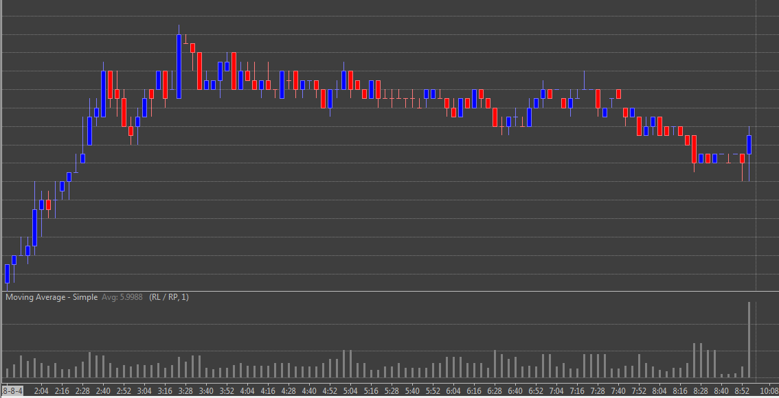

Recorded the formulas in the OPQR columns. On the basis of column Q, I constructed a bar chart. On the chart and in the table everything is displayed correctly. If the chart is recalculated (Insert), then the values in the column AA are played in the table. Recalculate All Formulas in the table does not change the situation. Indicator Moving Average - Simply from the chart does not disappear. Values in the AA can be restored by opening the settings Moving Average - Simple and after clicking OK. Why is this happening?
imagechart.png / V - Attached On 2018-08-04 10:01:29 UTC - Size: 12.48 KB - 593 views
imagebefore Insert.png / V - Attached On 2018-08-04 10:01:39 UTC - Size: 36.22 KB - 609 views
imageafter the insert.png / V - Attached On 2018-08-04 10:01:45 UTC - Size: 34.7 KB - 522 views
[2018-08-04 13:49:07]
I don't know.
But the bar graph is still displayed so it shouldn't matter unless you need the historical values on the spreadsheet for other calculations.
Here is a workaround to output all historical SMA values in a spreadsheet column:
Put this in S3:
=AVERAGE(OFFSET(Q3,0,0,1,1))
This is a formula to create a SMA on the spreadsheet, from examples here:
https://www.sierrachart.com/index.php?page=doc/SpreadsheetExampleFormulasAndUsage.php#SimpleMovingAverag

10. Can Spreadsheet System for Trading mark the bars (the second region) whose height is below 0.75?
tomgilb thanks for the help.
image10.png / V - Attached On 2018-08-05 09:53:37 UTC - Size: 46.34 KB - 583 views
[2018-08-05 14:18:17]
10.
What is your final goal for this?
If you are using the Spreadsheet System for Trading study for autotrading, it must be set to Region 1, which is what my previous posts are based on.
If you only want to produce a bar graph in Region 2, use the Spreadsheet Study study set to Region 2. In this case, you don't need to use the SMA to draw the bar graph in Region 2, and you could also use the spreadsheet to color the bars when <0.75.
If you also want alerts when the bar graph is <0.75, use the Spreadsheet System/Alert study set to Region 2.
To color the bars in Region 2 if the spreadsheet must use Region 1:
-Add the Color Bar Based On Alert Condition study.
-Set the 'Chart Region' to 2
-On the Subgraphs tab, set the Draw Style to 'Bar'
-On the Alerts tab, use this formula:
=ID1.SG1<0.75
This assumes the SMA study is ID1. Edit as necessary.
Note: The color bar study must be below the SMA study in the Studies to Graph list.

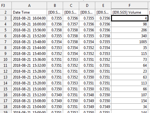

11. Did I correctly write down the condition?
(the average volume of four bars with a lag of -4 bars)> (the average volume of four bars with a lag of -8 bars)
R3
=AVERAGE(ID0.SG5@7:ID0.SG5@10) > AVERAGE(ID0.SG5@11:ID0.SG5@14)
