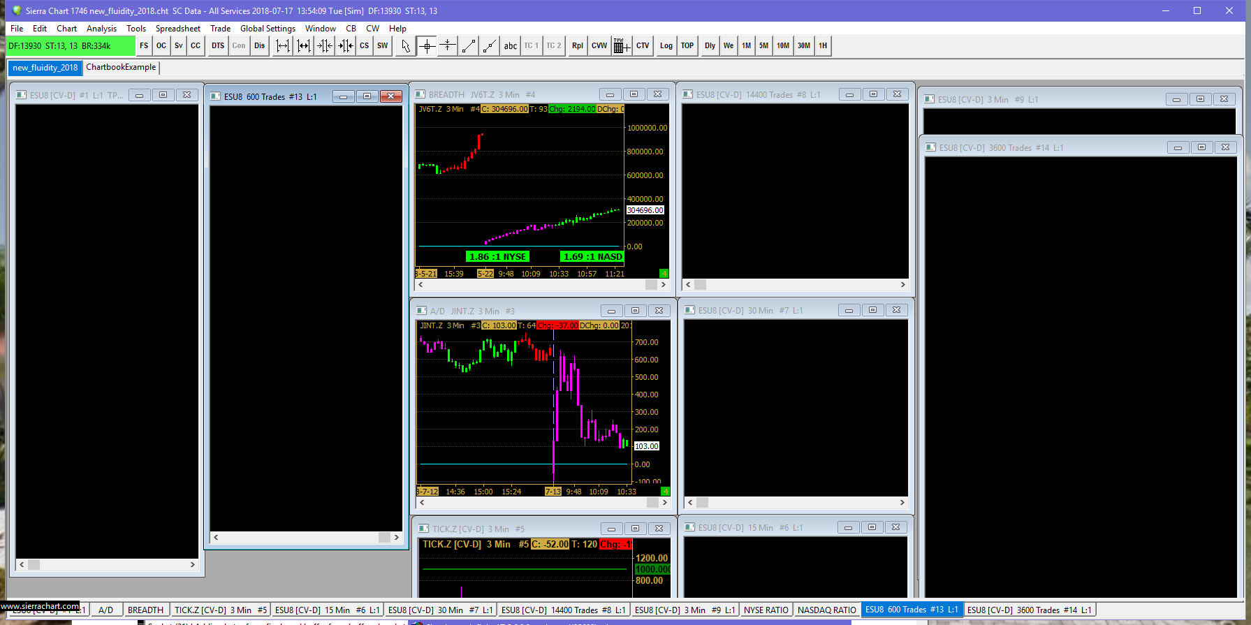

User436131 - Posts: 9
I've connected the action stated above to connect to transact and then reconnect to SC Data. My charts populated and looked good but have now "disappeared" and are just a blank black shell. http://www.sierrachart.com/image.php?Image=1531850054278.png
[2018-07-17 18:16:05]
Based upon the symbols you are using, which are Transact symbols, you need to keep Sierra Chart connected to Transact always instead of SC Data-All Services. Therefore, follow these instructions:
https://www.sierrachart.com/index.php?page=doc/SierraChartRealTimeFuturesStockDataFeed.php#IntegrationWithTradingServices
But that does not really explain why the charts are blank though. However, first step is to connect Sierra Chart to Transact and keep that connection.
Date Time Of Last Edit: 2018-07-17 18:18:14
[2018-07-17 19:04:38]
I do not want to use the bundled transact feed, I paid for the sierra feed so that I could get unbundled tic data that transact does not supply. It appears I just needed to choose the correct symbol from the available list of SC data and once I did that the charts populated. The symbols in my data files were from my previous set of free charts from transact and I was not aware i needed to choose the new SC feed symbol.
