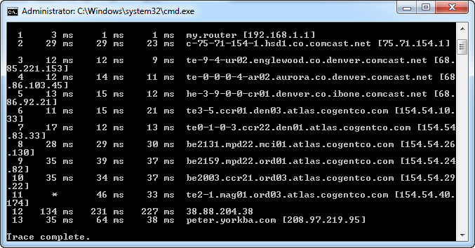

I have had a couple of issues lately, I have an auto trading study that tried to flatten and cancel my orders according to my exit order. However the charts showed a market order on the screen then would not get me out of the trade and left the order on the screen. When I flattened on the DOM my charts lost connection when they reconnected the orders were canceled and gone. Here is my message log for the trade:
Auto-trade: TFZ3 177 tick #3 | Uber On | There was an error flattening the position. Any working orders have been canceled for the symbol. | Bar Start Time: 2013-06-18 08:27:52 | 2013-10-16 08:59:39
Unable to cancel order without a Service Order ID. Internal Order ID: 41337 | 2013-10-16 08:59:41
There was an error with the order cancellation: Order cancellation failed. Internal order ID: 41337 | 2013-10-16 08:59:41
Trade Order Error: Unable to Flatten or Reverse because there are working Market orders that will flatten the position for symbol: TFZ3. Working orders for symbol are being canceled. | 2013-10-16 08:59:42
Auto-trade: TFZ3 177 tick #3 | Uber On | There was an error flattening the position. Any working orders have been canceled for the symbol. | Bar Start Time: 2013-06-18 08:27:52 | 2013-10-16 08:59:42
Unable to cancel order without a Service Order ID. Internal Order ID: 41337 | 2013-10-16 08:59:42
There was an error with the order cancellation: Order cancellation failed. Internal order ID: 41337 | 2013-10-16 08:59:42
I have run a Ping program to find out if there is package loss and I AM seeing some in the last few days, maybe the gap hit at exactly the same time as the cancellation order went in? Maybe you can see the internal id and let me know. I have run a trace and the issue looks to be right at the CME servers. tried to attache the image hope it comes through.
image10-16-2013 9-20-09 AM.png / V - Attached On 2013-10-16 14:21:43 UTC - Size: 29.08 KB - 640 views

What will help more is to provide the Trade Activity Log lines for the particular order that was sent to flatten the position. Here are the instructions:
http://www.sierrachart.com/index.php?l=doc/doc_TradeActivityLog.php#TradeActivityLogToSupport
We can only comment on what has happened. Once the orders are sent from Sierra Chart, we have no control after that.

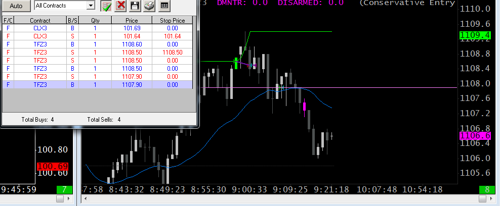

Here is the Trade Activity log for todays order error placement. The beginning of the Log shows the disconnection from the feed and then a reconnect and it got rid of the orders after I flattened from the DOM. Next I had placed a buy stop above price from the chart, Once the order was reflected on my DOM I chose "Flatten and Cancel" from the chart, just to see if there was something up, then the chart initiated a sell stop at 1107.5. Maybe it was thinking there was an order somewhere? After that order was flattened I tried to replicate the problem but it did not. You can see this in the following order cancellations on the log after the 1107.5 order.
Lets figure out whats going on, not trying to be pushy here, I am seeing something that isn't normal, thats all.
Here is todays trade activity log and the picture corresponds with the orders placed on the account.

image10-18-2013 9-21-31 AM.png / V - Attached On 2013-10-18 14:30:33 UTC - Size: 34.77 KB - 632 views
[2013-10-18 18:08:57]
If this is the stop order you are referring to, it was entered by you:
Order 2013-10-18 09:08:46.000 TFZ3 TFZ3 238 tick #3 | User order entry | Last: 1107.5 41508 Stop 1 Buy 1111.7 Order Sent 33166 Open
The log does not show that this order got filled:
Order 2013-10-18 09:01:05.002 TFZ3 TFZ3 238 tick #3 | User order entry | Last: 1108.6. Flatten&Cancel 41501 Market 1 Sell Order Sent 33166 Close 1
It shows that there was a connectivity problem and reported the order no longer working.
