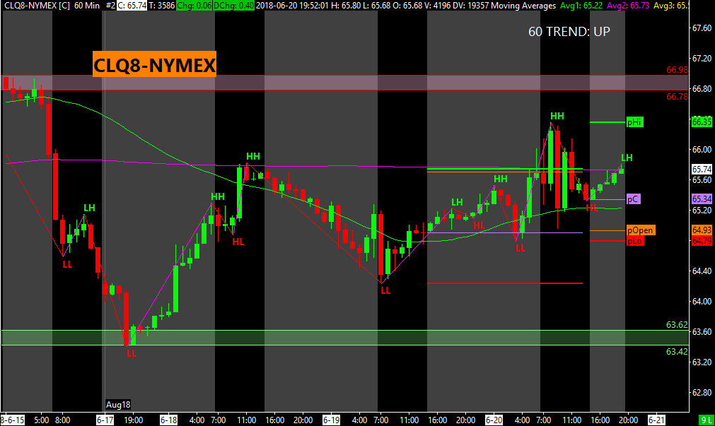

I would like to display TEXT on the chart. Specifically a Prefix + "UP" or "DOWN". The condition of the text could be the result of a "true" from an alert of another study.
The ideal situation would be for the resulting text to appear in a Stationary Text box where font and size can be easily adjusted.
Can this be done?

Chuck6475 - Posts: 24
Thanks for the reply BUT I don't see how this solves my issue.
My desire is to have a series of conditions to designate if the Trend is UP or Down and reflect that fact in writing on the chart. See image. Consider it a mock-up for what I'm trying to get to.

[2018-06-21 21:52:48]
In the next version of Sierra Chart these new inputs will be available with the Text Display for Study study which will accomplish what you need:
UseTextForNonZeroValue
NonZeroValueText
