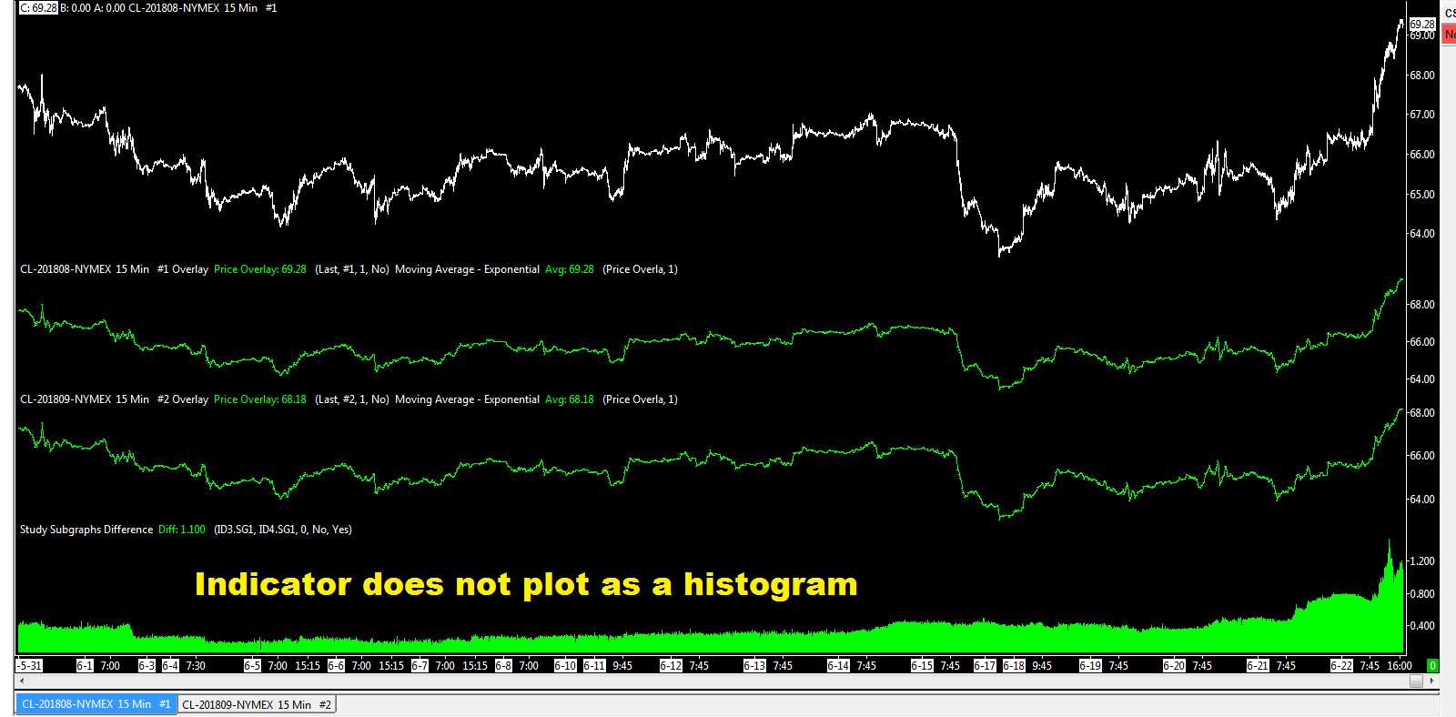

[2018-11-13 06:36:39]
rwilliams1 - Posts: 347
Thank you for the study collection you supplied a while back. I have been trying diligently to plot the difference between symbols as a histogram using your study collection, however, no matter what I try I cannot seem to get it to plot correctly. I am plotting a simple calendar spread of Oil CL as a test, but have not been successful.
I've attached a screenshot of what I am seeing and also the study collection parameters I am using. Any help you could provide on helping me to plot this correctly is greatly appreciated as I have not been able to figure it out. Thanks.

[2018-11-13 18:38:55]
What do you mean "indicator does not plot as a histogram"? What is wrong with what you see? What does a histogram mean for you?

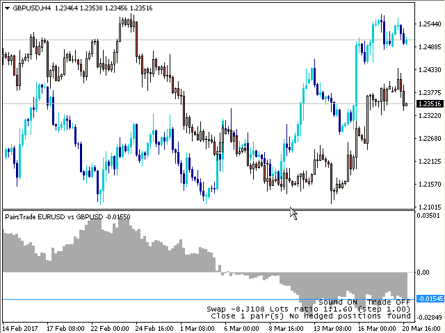

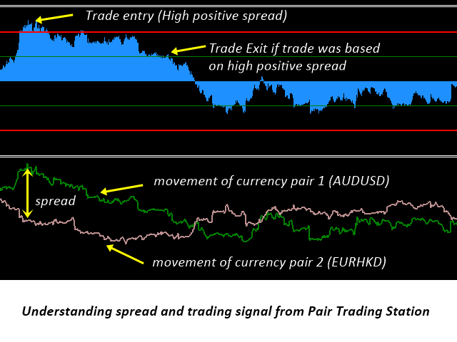

The histogram that I am referring to is one that oscillates above and below a zero center line similar to a MACD. Attached are two separate examples from Metatrader Pair trading indicators which I am trying to duplicate in SC.
imagePair Trade Histogram.png / V - Attached On 2018-11-13 20:54:24 UTC - Size: 25.34 KB - 633 views
imagePair Trade Histogram 2.png / V - Attached On 2018-11-13 20:54:31 UTC - Size: 11.18 KB - 595 views
[2018-11-14 06:15:26]
Okay not sure why we included the moving averages in the prior Study Collection we provided if you are not interested in calculating the difference between the averages of the underlying Overlay studies. Take those moving average studies out altogether.
And we see no reason why you would have a negative value calculating the difference between two different futures contract months where one is higher than the other.
We also want to point out that your Sierra Chart account is expired.
Date Time Of Last Edit: 2018-11-14 06:16:43
[2018-11-15 21:35:04]
Yes I'm guessing this is because it is plotting the absolute price difference between the two symbols instead of their relative movements. For example, if Symbol A is $100 and Symbol B is $50, then it will plot the indicator at 50. If neither symbol is volatile enough to close the $50 price gap difference, then a price oscillation above/below the zero line will not occur. Can you tell me if there is a way to configure/normalize this Study subgraphs Difference Indicator in a way that will allow me to compare the RELATIVE movement of two symbols in histogram form as shown in my earlier attached screenshots?
I also had a question about your Spread 4 indicator and other spread/difference indicators. I noticed that the live bars REPAINT and do not print the wicks of the live bar's price movement. So there is no way of knowing how high or low the current bar has been. Is there a way to fix this?
And thanks for alerting me about my account, yes I was aware it had expired, but I was going to first work out this indicator situation before subscribing again which I have now done.
[2018-11-16 03:26:05]
I've been playing with the Offset parameter in the Study Subgraphs difference to try and align both symbols to view their relative performance. I offset one symbol by the amount of the difference between the two symbols so that they both start at a similar reference point value. By doing this I am now able to view a histogram that oscillates above and below the zero line.
But I am curious if this is what the Offset parameter is used for? There is no description of the parameter but I am assuming it is used to align two symbols. Is this the purpose of this parameter and am I using it correctly? Thanks again.
