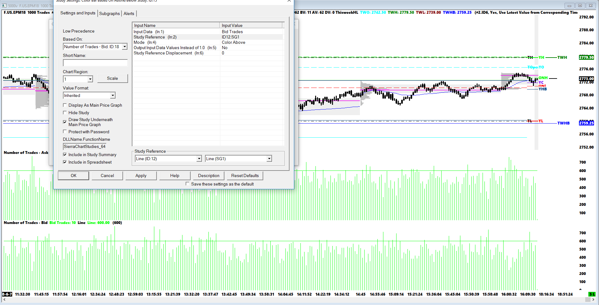

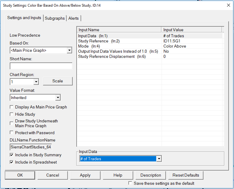

Attached is my issue. When I use the the "number of trades" study, the color bar above/below options matches up with a "# of trades" option.. When I put on "number of trades bid", or "number or trades ask", there is no option to match on the color bar above/below study. "# of trades", or "bid volume", or "ask volume" do not work or match.

imageNumber of Trades.png / V - Attached On 2018-05-21 20:53:15 UTC - Size: 2.07 KB - 566 views
image#ofTrades.png / V - Attached On 2018-05-21 20:54:33 UTC - Size: 33.25 KB - 461 views
imageColorBarOptions.png / V - Attached On 2018-05-21 20:55:14 UTC - Size: 4.41 KB - 552 views

We would have to test this, but the solution for this is to base that particular Color Bar study on the Number of Trades-Ask or Bid study:
http://www.sierrachart.com/index.php?page=doc/ChartStudies.html#BasedOn

User508406 - Posts: 6
Tried the Above. Still not working. It works for bid and ask volume perfect though.
imageBidTradesAskTradesColor.png / V - Attached On 2018-06-07 21:50:51 UTC - Size: 112.37 KB - 549 views
