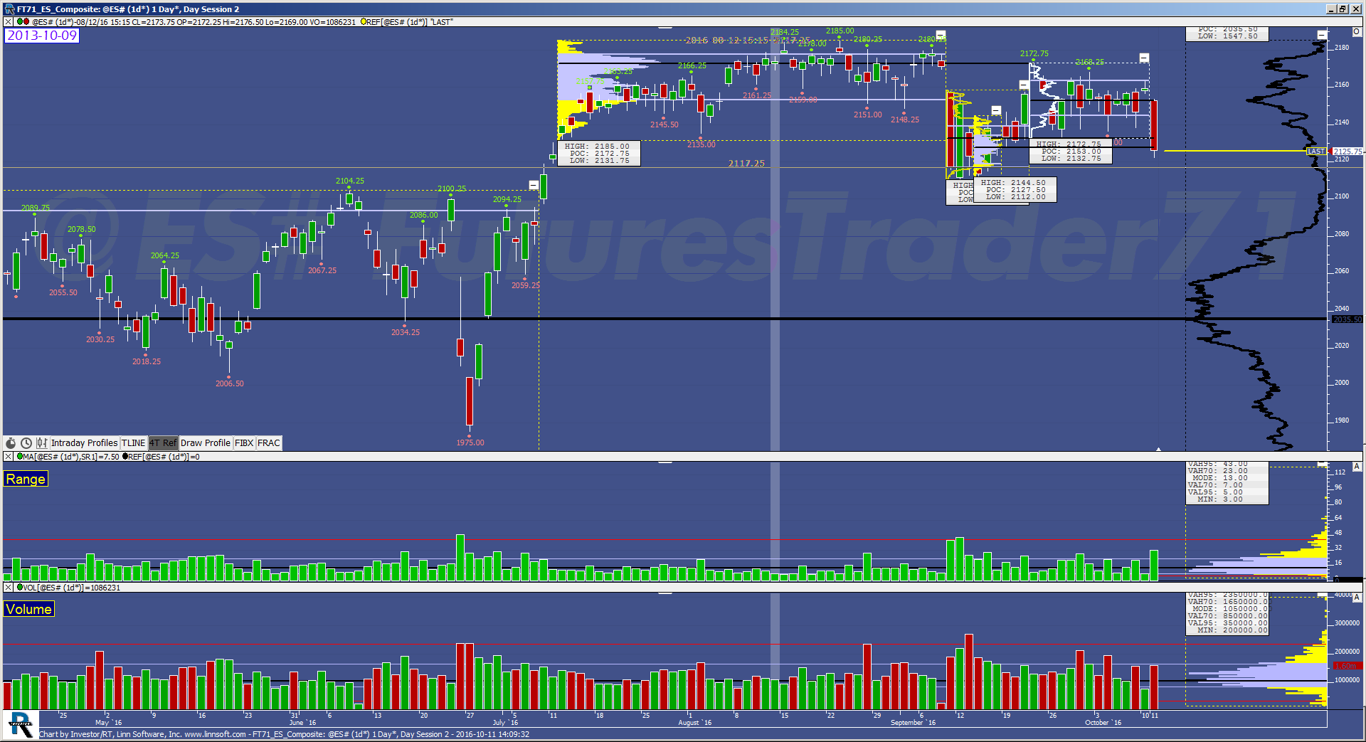

I am also interested and here is a reference picture, look at the bottom 2 regions, they have a profile based on the volume and range.
imageft71escomposite161011140931.png / V - Attached On 2018-06-14 12:29:21 UTC - Size: 112.88 KB - 655 views
[2018-06-14 19:12:44]
At this point it is safest for us to say that what you are looking for is not supported.
You could try using the Subgraph >>Draw Style referenced in our prior post. Here is the setting for this:
Chart Studies: Subgraphs Tab >> Draw Style
We will not provide any further support on this because inevitably you are going to come back saying that it is not what you want.
