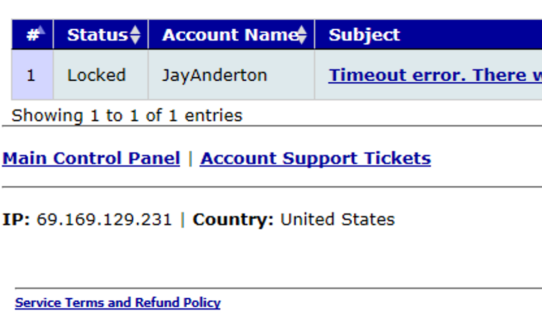

[2018-04-25 00:57:03]
User959325 - Posts: 4
This is the IP at the bottom of your web page (I can send you a screen shot to prove it). Hmmm...
Yes, as I explained in the other post I have completed all the steps as outlined in your Thread including the Proxy Server (I don't have need of them and the other set up in my home does not have them and is working no problem). You all are a cheeky group based on the responses you provide to your customers. Sierra Chart is critical to my operations, so would really love your help, but I can also appreicate you feeling like I am wasting your time or that my reqeust for assitance is below your level of enginneering skill. I wish I didn't need your assistance and didn't have the "timeout" problem, but alas Sierra Charts is important to our operations.
If you have no other recommendations based off your vast experince I will bid you good day (and not waste your time any more). If on the other hand, you have another possible solution I would love you recommending something.
Thank you.
imageScreen Shot 2018-04-24 at 6.41.54 PM.png / V - Attached On 2018-04-25 00:44:12 UTC - Size: 233.79 KB - 575 views
[2018-04-25 01:37:43]
What we are going to do is improve the message, so we can determine precisely what the socket error is. We will have this done by morning.
The next step is we just have to connect to your system and see what we can figure out. We know that the problem is almost certainly on your system itself.
That IP address you see as your own IP which is in Utah.
