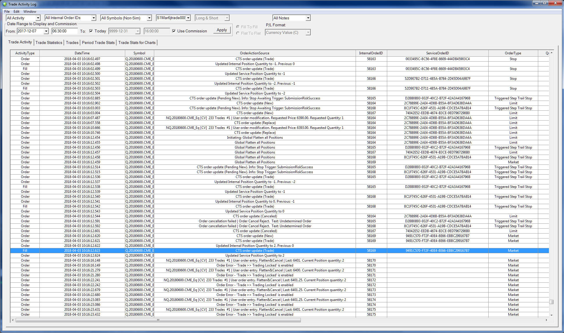

[2018-04-10 19:31:03]
User169205 - Posts: 72
attached is a screen cap of the tal for the instance in question.. phantom order is highlighted..
image040318_tal_ User169205.png / V - Attached On 2018-04-10 19:30:32 UTC - Size: 268.49 KB - 458 views

[2018-04-11 03:21:56]
We can now explain what has happened.
Your automated trading system submitted Attached Orders with the parent order.
These are server-side attached orders. The global Profit/Loss Management, sent a cancel request for the orders and a market order to flatten the position. However, the existing Attached Stop orders filled at the same moment and could not be canceled. This is why you ended up being long 2.
ActivityType  DateTime  Symbol  OrderActionSource  InternalOrderID  ServiceOrderID  OrderType  Quantity  BuySell  Price  Price2  OrderStatus  FillPrice  FilledQuantity  TradeAccount  OpenClose  ParentInternalOrderID  PositionQuantity  FillExecutionServiceID  HighDuringPosition  LowDuringPosition  Note
Order  2018-04-03 10:16:12.455  NQ.20180600.CME_Eq  Global Flatten all Positions  58164  2C78899E-2AE4-4D8B-B55A-8F3AD638DA4A  Limit  1  Buy  639300.0000000    Pending Cancel      S1Mar6jtrade888  Close  58163  -2
Order  2018-04-03 10:16:12.456  NQ.20180600.CME_Eq  Global Flatten all Positions  58165  D2BB0B93-932F-40C2-B72F-42A3A416796B  Triggered Step Trail Stop  1  Buy  640100.0000000    Pending Cancel      S1Mar6jtrade888  Close  58163  -2
Order  2018-04-03 10:16:12.457  NQ.20180600.CME_Eq  Global Flatten all Positions  58167  74042E52-EEDB-4674-B3CE-9ED7967298B0  Limit  1  Buy  638800.0000000    Pending Cancel      S1Mar6jtrade888  Close  58166  -2
Order  2018-04-03 10:16:12.458  NQ.20180600.CME_Eq  Global Flatten all Positions  58168  8C1F745C-626F-4531-A19B-CDCE5A7BAB14  Triggered Step Trail Stop  1  Buy  640100.0000000    Pending Cancel      S1Mar6jtrade888  Close  58166  -2
Order  2018-04-03 10:16:12.459  NQ.20180600.CME_Eq  Global Flatten all Positions  58169    Market  2  Buy      Order Sent      S1Mar6jtrade888  Close    -2
Order  2018-04-03 10:16:12.514  NQ.20180600.CME_Eq  CTS order update (Pending New). Info: Stop Trigger: SubmissionRiskSuccess  58165  D2BB0B93-932F-40C2-B72F-42A3A416796B  Triggered Step Trail Stop  1  Buy  640100.0000000    Open      S1Mar6jtrade888  Close    -2
Order  2018-04-03 10:16:12.515  NQ.20180600.CME_Eq  CTS order update (Pending New). Info: Stop Trigger: SubmissionRiskSuccess  58168  8C1F745C-626F-4531-A19B-CDCE5A7BAB14  Triggered Step Trail Stop  1  Buy  640100.0000000    Open      S1Mar6jtrade888  Close    -2
Order  2018-04-03 10:16:12.536  NQ.20180600.CME_Eq  CTS order update (Trade)  58165  D2BB0B93-932F-40C2-B72F-42A3A416796B  Triggered Step Trail Stop  1  Buy  640100.0000000    Filled  640100.0000000  1  S1Mar6jtrade888  Close    -2
Order  2018-04-03 10:16:12.537  NQ.20180600.CME_Eq  Updated Internal Position Quantity to -1. Previous: -2                Unspecified      S1Mar6jtrade888
Fill  2018-04-03 10:16:12.538  NQ.20180600.CME_Eq  CTS order update (Trade)  58165  D2BB0B93-932F-40C2-B72F-42A3A416796B  Triggered Step Trail Stop  1  Buy  640100.0000000    Filled  640100.0000000  1  S1Mar6jtrade888  Close    -1  D2BB0B93-932F-40C2-B72F-42A3A416796B_0_T  640125.0000000  639525.0000000
Order  2018-04-03 10:16:12.539  NQ.20180600.CME_Eq  Updated Service Position Quantity to -1                Unspecified      S1Mar6jtrade888
Order  2018-04-03 10:16:12.540  NQ.20180600.CME_Eq  CTS order update (Trade)  58168  8C1F745C-626F-4531-A19B-CDCE5A7BAB14  Triggered Step Trail Stop  1  Buy  640100.0000000    Filled  640100.0000000  1  S1Mar6jtrade888  Close    -1
Order  2018-04-03 10:16:12.541  NQ.20180600.CME_Eq  Updated Internal Position Quantity to 0. Previous: -1                Unspecified      S1Mar6jtrade888
Fill  2018-04-03 10:16:12.542  NQ.20180600.CME_Eq  CTS order update (Trade)  58168  8C1F745C-626F-4531-A19B-CDCE5A7BAB14  Triggered Step Trail Stop  1  Buy  640100.0000000    Filled  640100.0000000  1  S1Mar6jtrade888  Close      8C1F745C-626F-4531-A19B-CDCE5A7BAB14_0_T  640100.0000000  640100.0000000
Order  2018-04-03 10:16:12.543  NQ.20180600.CME_Eq  Updated Service Position Quantity to 0                Unspecified      S1Mar6jtrade888
Order  2018-04-03 10:16:12.544  NQ.20180600.CME_Eq  CTS order update (Canceled)  58164  2C78899E-2AE4-4D8B-B55A-8F3AD638DA4A  Limit  1  Buy  639300.0000000    Canceled      S1Mar6jtrade888  Close
Order  2018-04-03 10:16:12.591  NQ.20180600.CME_Eq  Order cancellation failed | Order Cancel Reject. Text: Undetermined Order  58165  D2BB0B93-932F-40C2-B72F-42A3A416796B  Triggered Step Trail Stop  1  Buy  640100.0000000    Error  640100.0000000  1  S1Mar6jtrade888  Close
Order  2018-04-03 10:16:12.592  NQ.20180600.CME_Eq  Order cancellation failed | Order Cancel Reject. Text: Undetermined Order  58168  8C1F745C-626F-4531-A19B-CDCE5A7BAB14  Triggered Step Trail Stop  1  Buy  640100.0000000    Error  640100.0000000  1  S1Mar6jtrade888  Close
Order  2018-04-03 10:16:12.601  NQ.20180600.CME_Eq  CTS order update (Canceled)  58167  74042E52-EEDB-4674-B3CE-9ED7967298B0  Limit  1  Buy  638800.0000000    Canceled      S1Mar6jtrade888  Close
Order  2018-04-03 10:16:12.620  NQ.20180600.CME_Eq  CTS order update (New)  58169  9491C570-F72F-40E4-8E66-EBBC299167B7  Market  2  Buy      Open      S1Mar6jtrade888  Close
Order  2018-04-03 10:16:12.621  NQ.20180600.CME_Eq  CTS order update (Trade)  58169  9491C570-F72F-40E4-8E66-EBBC299167B7  Market  2  Buy      Filled  640225.0000000  2  S1Mar6jtrade888  Close
Order  2018-04-03 10:16:12.622  NQ.20180600.CME_Eq  Updated Internal Position Quantity to 2. Previous: 0                Unspecified      S1Mar6jtrade888
Fill  2018-04-03 10:16:12.623  NQ.20180600.CME_Eq  CTS order update (Trade)  58169  9491C570-F72F-40E4-8E66-EBBC299167B7  Market  2  Buy      Filled  640225.0000000  2  S1Mar6jtrade888  Open    2  9491C570-F72F-40E4-8E66-EBBC299167B7_0_T
Order  2018-04-03 10:16:12.624  NQ.20180600.CME_Eq  Updated Service Position Quantity to 2                Unspecified      S1Mar6jtrade888
