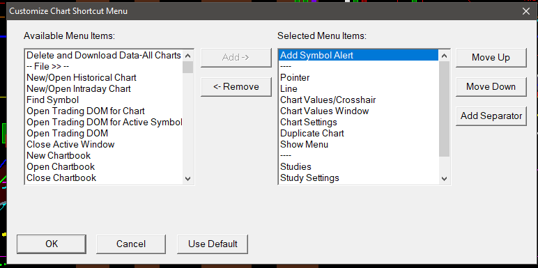

You can quickly do this from the Add Symbol Alert tool. This is found under Window/Alert Manager/Symbol Alerts (Tab)/Add Symbol Alert. Your alert choices are available in the selection window (see below). To make this faster and actually useful, add the Add Symbol Alert to your Chart shortcut menu via Global Settings/Customize Chart Shortcut Menu and you can select it via right click right on your chart. Your price will be the point you clicked your mouse for the alert.

imageAdd Symbol Alert.PNG / V - Attached On 2018-01-25 17:29:39 UTC - Size: 14.71 KB - 1036 views
imageShortcut Menu.PNG / V - Attached On 2018-01-25 17:29:47 UTC - Size: 25.02 KB - 869 views
