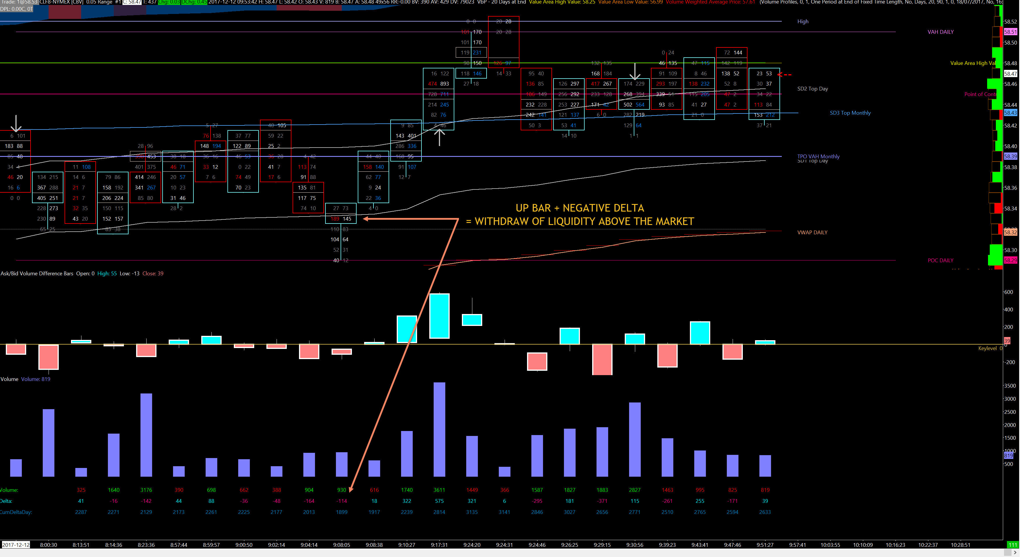

Hello Support,
i would like to know if it is technically possible to define an alert when these 2 conditions are met ?
UP BAR + NEGATIVE DELTA or DOWN BAR + POSITIVE DELTA ? (Please see attached screenshot illustrating the first situation.)
Besides, i wanted to have confirmatinon that it is nearly impossible to have a countdown on a rangebar chart, right ?
It is not possible to have any clue when a period on a footprint will end.
Thanks !
imagesc_OneUp_CLF8_121217_Footprint_5R_Delta-Divergence.jpg / V - Attached On 2017-12-12 09:01:25 UTC - Size: 980.79 KB - 1847 views
[2017-12-12 19:03:09]
You can certainly write an Alert Formula to accomplish this. Refer to:
Study/Chart Alerts And Scanning
You will want to use these special functions to access the Volume at Price data:
Study/Chart Alerts And Scanning: Special Functions
And refer to:
Numbers Bars: Referencing Numbers Bars Calculated Values Subgraphs in Alert Formulas
Date Time Of Last Edit: 2017-12-12 19:03:15
[2017-12-12 19:06:08]
Refer to the response above.
The Countdown Timer does work with Range bars, but it does not indicate when a new bar will start unless you use this Bar Period Type:
Chart Settings: Range Per Bar - New Bar on Range Met (in ticks) (Chart >> Chart Settings >> Bar Period >> Intraday Chart Bar Period >> Bar Period Type
Date Time Of Last Edit: 2017-12-12 19:06:36
