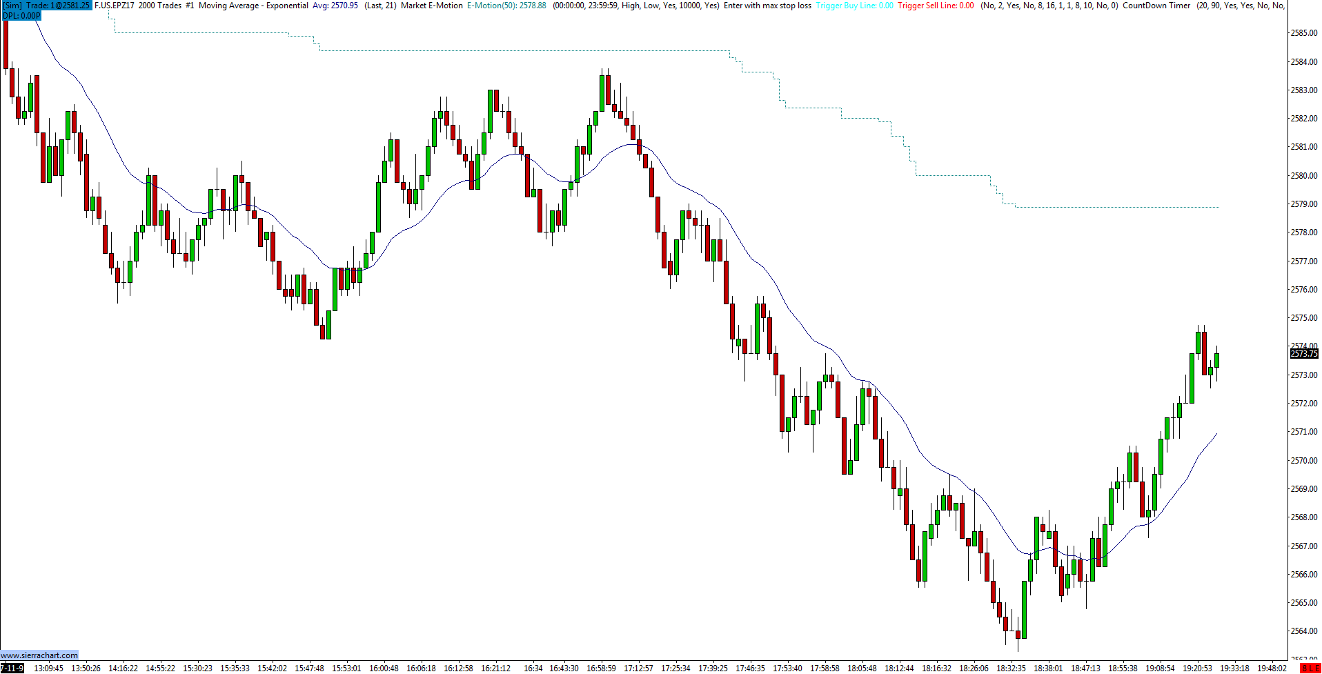

In the screenshot in my first message, the first arrows points to a candlestick that opens four ticks above the close of the previous candlestick, which means there is a problem with the data (there is a gap between the two candlesticks, which can happen occasionally, but not 4 ticks and not so often, especially with the S&P 500 e-mini). This is only one example, and I pointed out several others with the other arrows. And it happens every day, with:
- Tick and volume charts (I use mainly tick charts for trading) only.
- Futures contracts prior to June 2017. F.US.EPZ17, F.US.EPU17 and F.US.EPM17 are fine, but F.US.EPH17 and prior contracts are not and I need to work on this data for the replay.
I attached a screenshot of F.US.EPZ17 so you can see the difference with the first screenshot. I don't believe the service package is the issue, because both F.US.EPM17 and F.US.EPH17 are historical data, but the latter seems corrupted. I use CQG data.
Do you see now what I mean? Do you see the difference between the two screenshots?

Listen to what we tell you. Change your service package to 5:
To change your Sierra Chart Service Package, select "Help >> Account Control Panel" on the Sierra Chart program menu. On the displayed webpage, click on the "Set Service Package for Renewal" link.
Or go to this page:
https://www.sierrachart.com/UserControlPanel.php?page=ServicesActivation
You will need to login if you are not currently logged in.
In the "Available Services >> Choose Usage Time Service Package" frame, select the Service Package that you want to set your account to. Press the "Set" button.
The remaining service usage time on your account will be adjusted based upon the cost of the package you are changing to. If the new package is a higher-priced package, then the usage time will be reduced due to the higher price.
There is no charge for changing your Sierra Chart service package. Only your Sierra Chart account usage time ending date is adjusted.
Follow the instructions here for tick by tick data configuration:
Your problem will be resolved.

The problem is resolved with the service package 5. Thank you.
