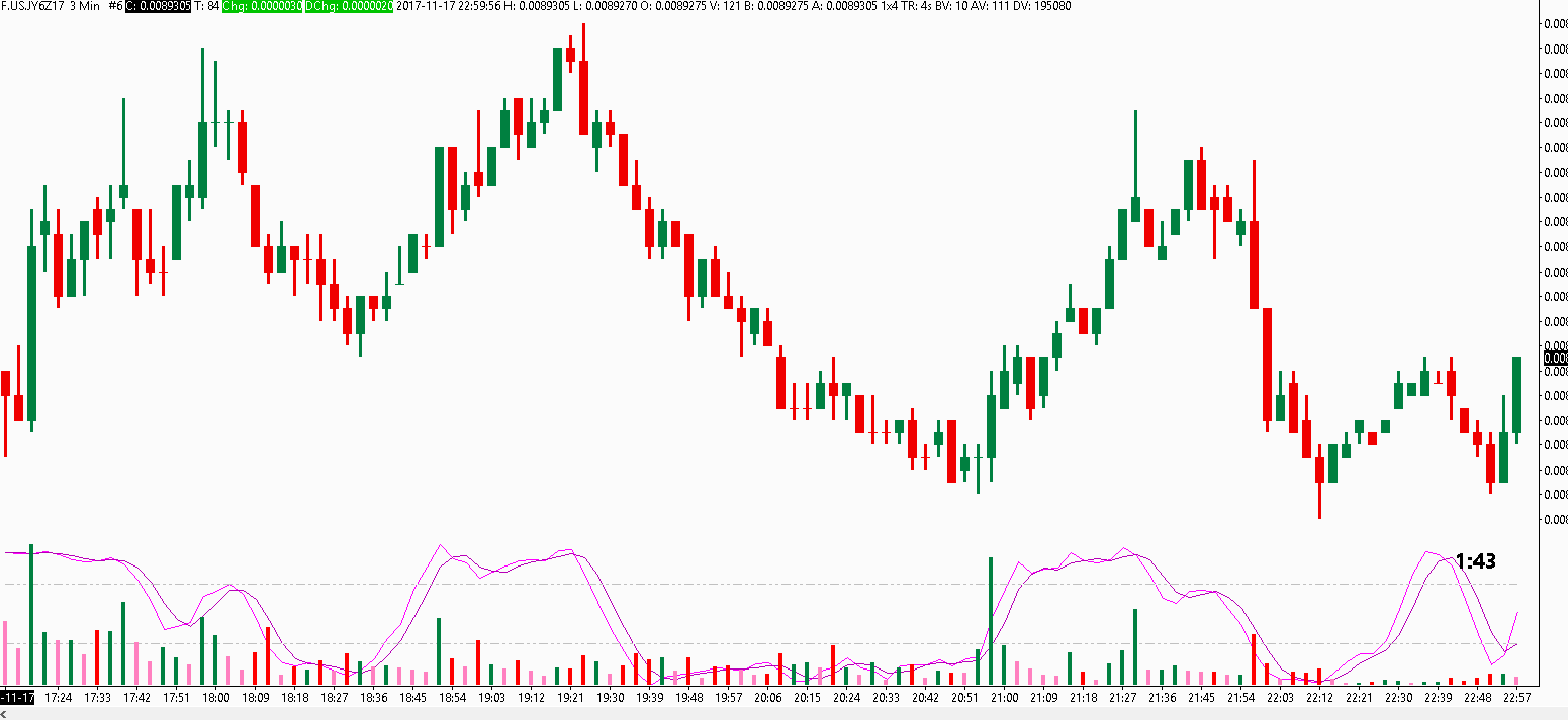

Trying to assist a customer. They have a little bit of space to the right side of their chart using the "Lock fill space" option and the customer would like to put the countdown timer in region 2 of the chart layout. When we make the change we are not able to draw lines in region 2, which is something we would like to do regardless what scale of the countdown timer we use. In region 2 (Right below the main chart) we have two indicators. The first one is Stochastic and the second one is custom Volume Indicator. In the attachment is a screenshot from the platform to show exactly what it looks like. We would like to have the count down timer exactly where it is on the screenshot however be able to draw for example a trend line in region 2. When we put the countdown timer in region 2 it seems to decrease the high of the volume, and change the scale of the chart.

[2017-11-20 19:41:23]
In the list of studies on the chart, move the Countdown Timer to the bottom of the list. Refer to:
Chart Studies: Study Display Order
