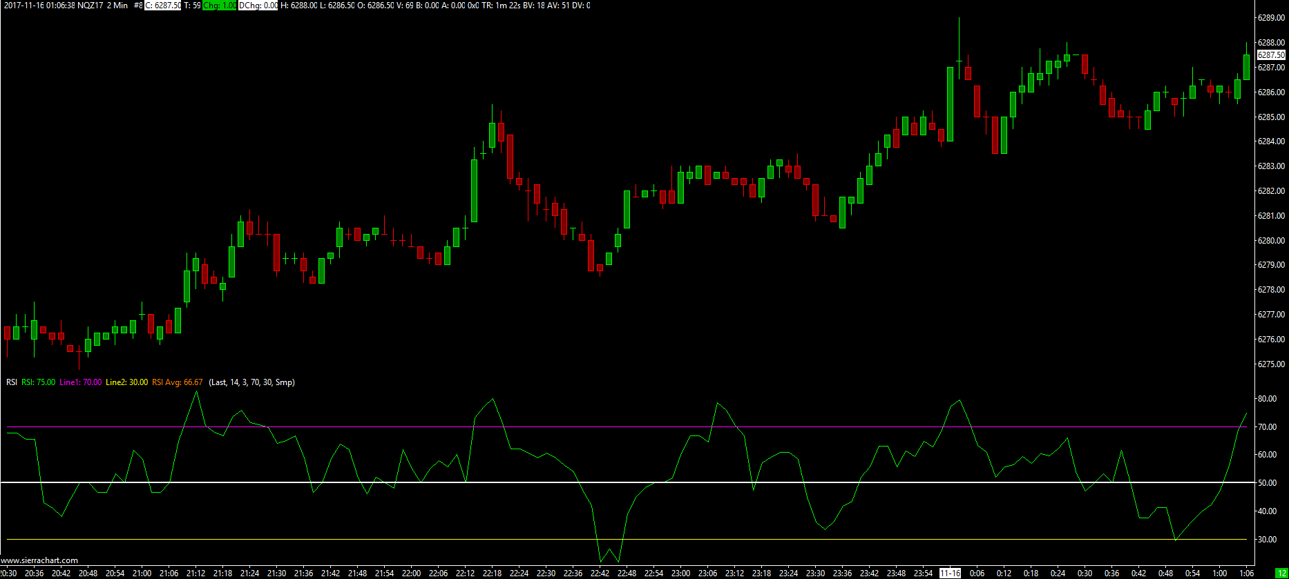

I have manually drawn a line on the 50.00 level for the RSI indicator on the chart. Is there anyway I can auto-color the RSI line based on it being above or below the 50.00 level? When the RSI is above 50.00 I would like it to appear as green and when it is below the 50.00 it appears as red. I appreciate any suggestions. Thank you.
http://www.sierrachart.com/image.php?Image=1510817910960.png
[2017-11-16 17:52:09]
Refer to this page:
Color Bar Based on Alert Condition
Specifically to this section:
Color Bar Based on Alert Condition: Coloring Subgraphs of Other Studies (ColoringSubgraphsOfOtherStudies)

[2017-11-17 08:01:08]
User585845 - Posts: 17
I'm having a hard time with the instructions and getting this to work. What exactly do I need to do in order to get the RSI to color green when its value is higher than 50 and red when its value is lower than 50? I only need the RSI to change color based on its value, not the price bars.
