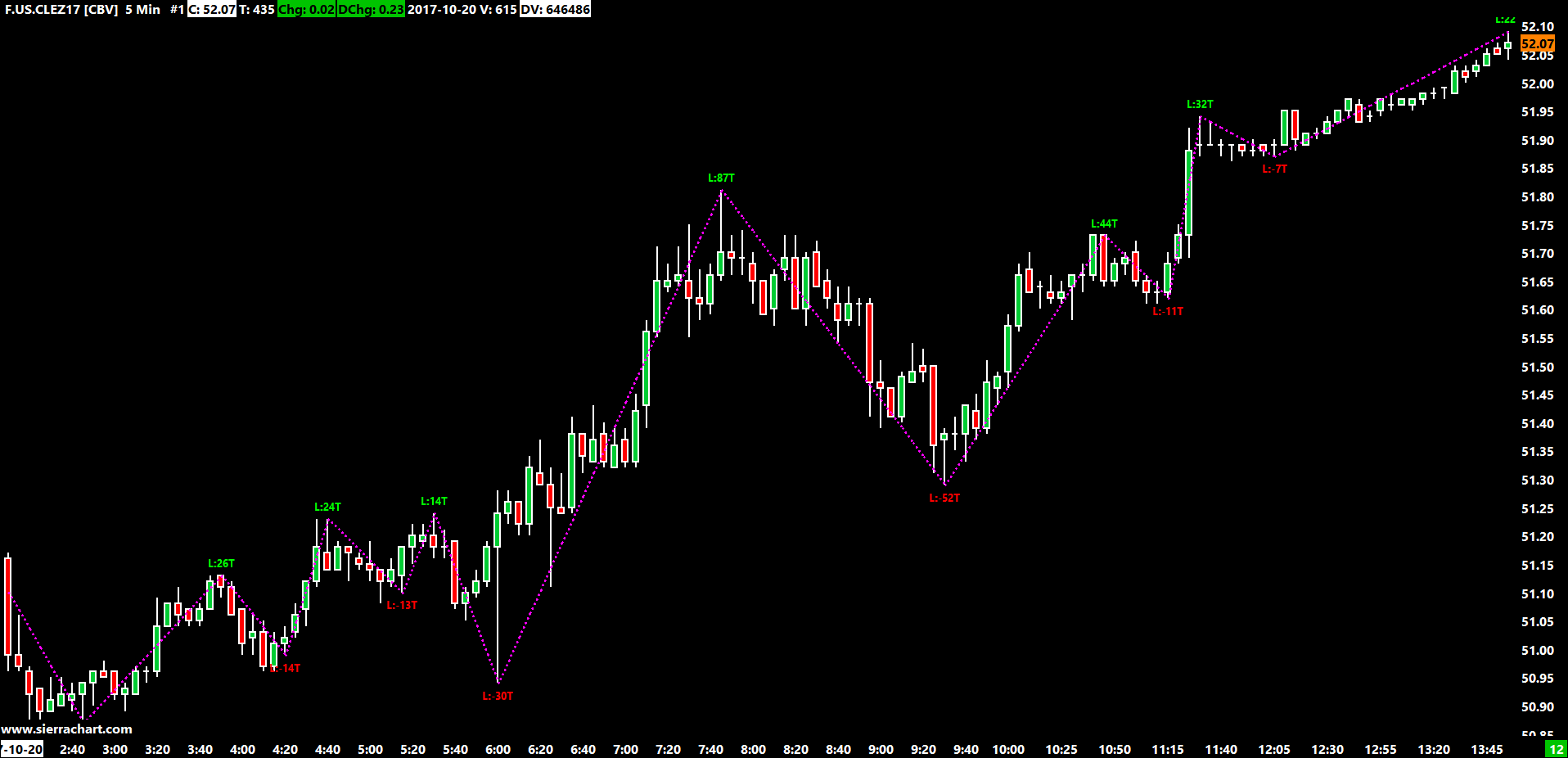

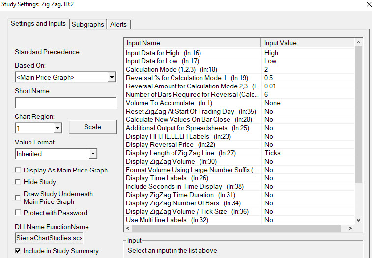

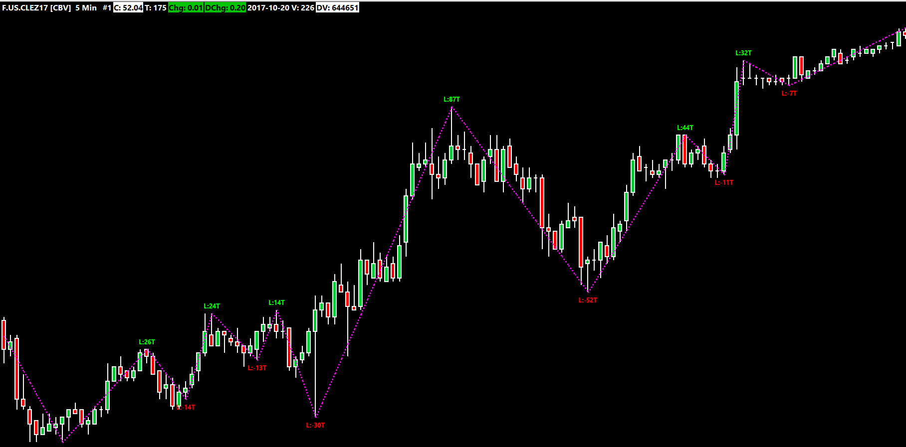

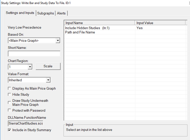

I am trying to get a specific data set from this study and I can't seem to make it work. I have placed a zig-zag study on a 5 minute CL chart with only the tick line length and the tick line showing. I have placed the Study Setting: Write Bar and Study Data to File study on it and downloaded the information. When I load the data in excel it only show the first 2 tick line length numbers on it and then all zeros from the first two on. I can't figure out what I am doing wrong. I have read your instruction several times and I don't see why it won't work. I have attached screen shots of the chart the inputs on the studies and a the excel print out.

[2017-10-23 02:18:19]
What we want you to do is to use the Spreadsheet Study and then make reference to a particular column outputted by the Spreadsheet study and let us know what the issue is with that.
The Zig Zag study has an Input for Additional Output for Spreadsheets. Make sure you set that to Yes.

OK. If you still need help we need to know specifically what you need:
Maybe you want to set this Input with the Zig Zag study to Yes:
Zig Zag: Additional Output for Spreadsheets

User807026 - Posts: 86
I have set up 2 different charts of CL, one with a 5 minute time frame and the other with a 30 minute time frame. I have put a zigzag study on both with only the lines and the length of the line being displayed. I then set up 2 different spreadsheets one for each chart and put a spreadsheet study on both. The settings on both spreadsheets studies are identical. The data on the 5 minute spreadsheet shows all the data from the chart, the data on the 30 minute spreadsheet does not show the length of the zigzag line which is the one piece of data that I am looking for. I have deleted the 30 minute spreadsheet and set it up several time. I have tried reloading and recalculating the chart several times and the data for the length of the zigzag line does not show up on that spreadsheet like it does on the 5 minute spreadsheet.
