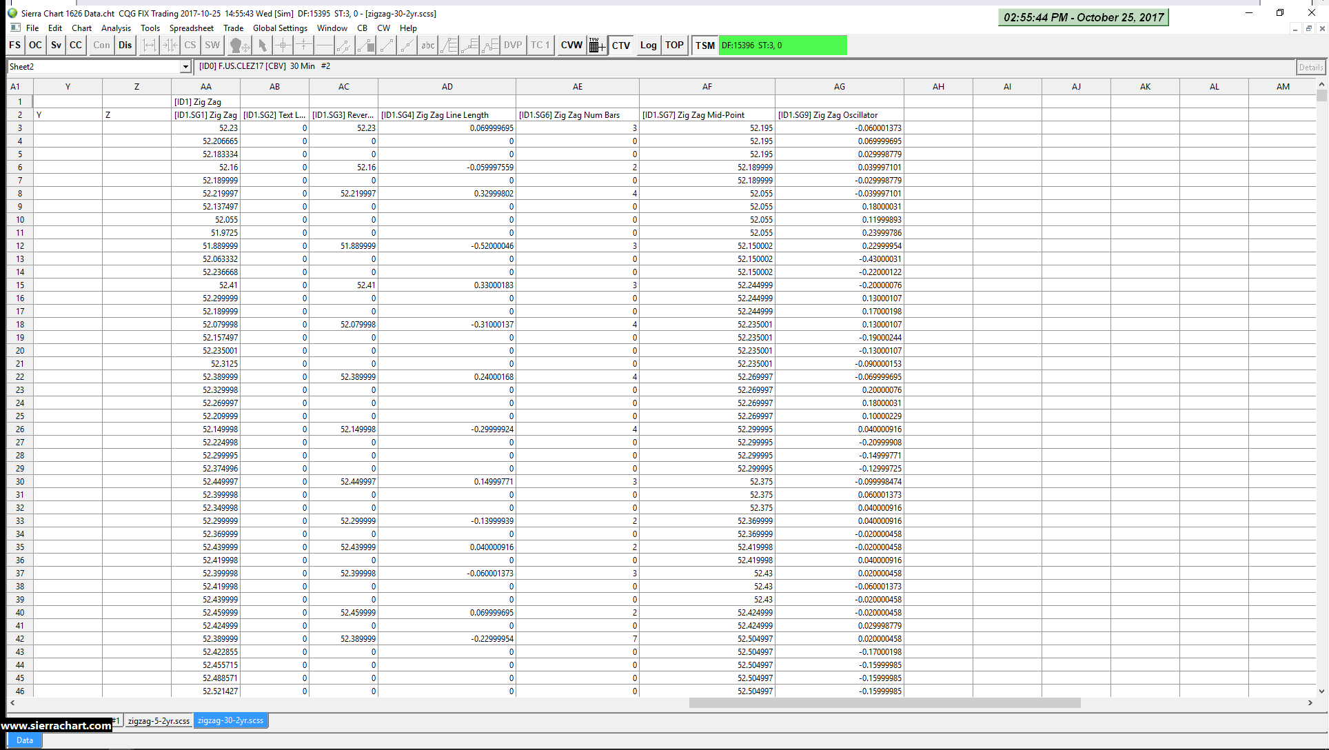

The question is do you see the column? Attach a screenshot of the Sheet showing what you see. Here are instructions:
Date Time Of Last Edit: 2017-10-25 17:27:02
[2017-10-25 21:56:03]
User807026 - Posts: 86
http://www.sierrachart.com/image.php?Image=1508968545226.png
[2017-10-26 20:04:48]
We are not understanding this because we do see this information on the sheet provided in post #9:
the data on the 30 minute spreadsheet does not show the length of the zigzag line which is the one piece of data that I am looking for. I
We clearly see the Zig Zag Line Length column with data.
Date Time Of Last Edit: 2017-10-26 20:05:52
[2017-10-26 20:40:27]
It does show now, it wasn't previously.
