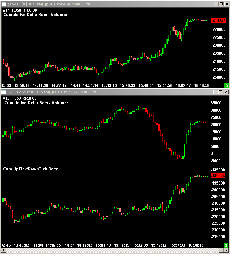

The Cumulative Delta Bars - Up/Down Tick Volume study with TT data is very close to the Cumulative Delta Bars - Volume study with IQFeed data. Attached is a comparison I did last year.
The upper panel is Cumulative Delta Bars - Volume study with IQFeed data.
The middle panel is Cumulative Delta Bars - Volume study with TT data.
The lower panel has cumulative delta bars made from Up/Down ticks with TT data.

imagecum_delta.png / V - Attached On 2013-09-06 15:09:40 UTC - Size: 45.1 KB - 2165 views
